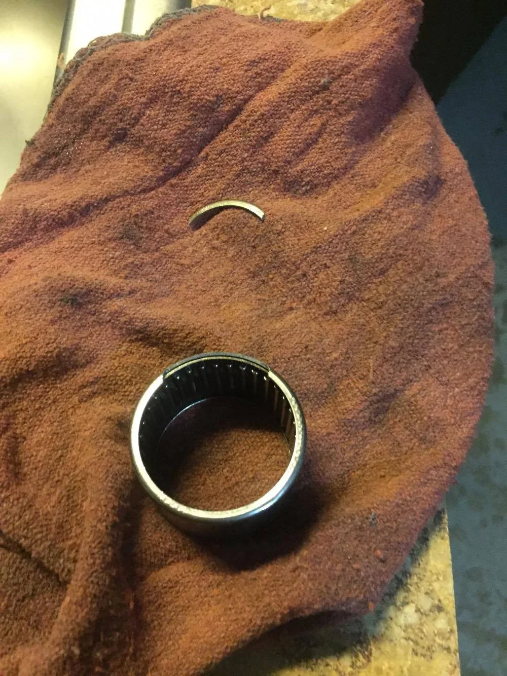

Just got done installing the ECGS bushing. The rumbling and light vibration is completely gone. I'm very happy and well worth it. We followed the video on their website and had no problems. While removing the old needle bearing the inside edge cracked off but it still came right out. The tool worked just as described and we think it was a tad crooked when we started pulling it out is all. I have a pic if anyone wants to see. I'm back to completely loving my truck again!
I'm glad it fixed the vibration/hum. Can't wait for it to fix mine (parts are on the way). Share the pic, I wanna take a look at it. Thanks.
I got impatient and did it myself. It was cake! Humming is completely gone!! Took me about 45 mins or so (with a lift) I am also back to loving my truck again! I broke mine taking it out, attached photo so everyone can see!

Nice work! Glad you got it back to normal. Mine is still driving great. No noise at all. Mine cracked exactly the same way.
