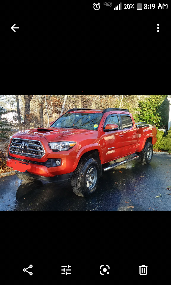

I have 265-70-17 , hankooks on 17x9 -12 , 4.5 backspace they rubbed so I lifted 1.5 all round .prolly shoulda went with the 8' s .I think they had -6 offset .
I just replaced my gray wheels and 245/75/16 stock wheels on my SR5 with the grille and 275/80/16 wheels take offs from a TRD Off Road
