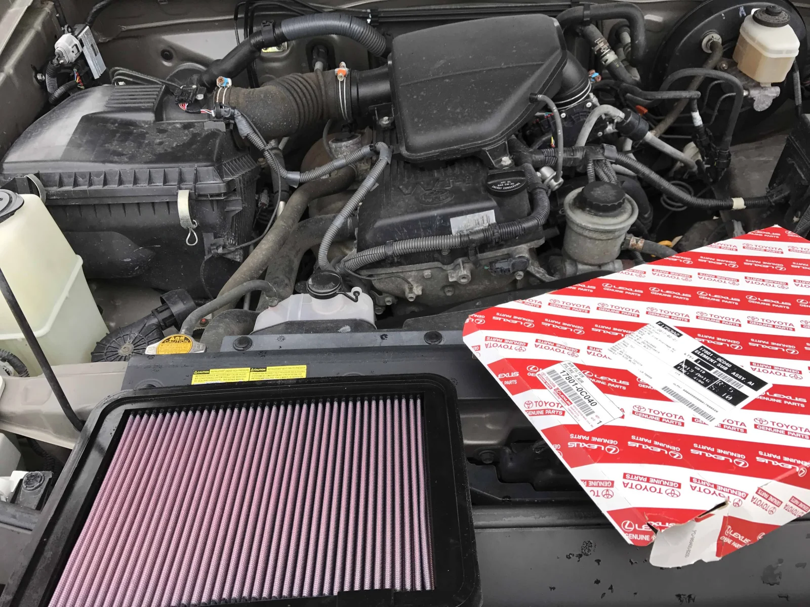

I use to be a hard core k&n fan. But once I went back to a stock filter not only did I have peace of mind but seems to run better felt like I was loosing power with the k&n.IMG_1309.webp
