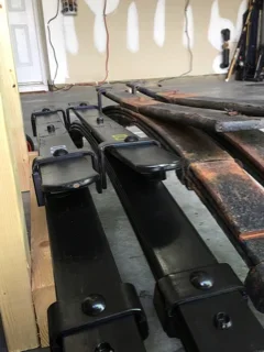

Well heres my story. 08 Taco with 6" lift. Put the new springs on it from the dealership. Got back the truck and noticed the back rns was sagging. It sagged 2 1/2" with the new leaf springs. Not a happy camper. The dealership didnt know what to do and told me to lower the front of the truck to make it level. I have now ordered new leaf springs and will be put on the truck tomorrow. Still haven't heard back from the dealership with "there" fix. I love my truck just over the rust issues.
Well today i had someone install the skyjacker leaf springs and of coarse the truck is back to normal. Looked at the old springs and the newly replaced springs from the recall and found out why the truck was sagging. ImageUploadedByTaco Forum1464898641.020960.webp
Well today i had someone install the skyjacker leaf springs and of coarse the truck is back to normal. Looked at the old springs and the newly replaced springs from the recall and found out why the truck was sagging. View attachment 9144
So the new leaf springs weren't the problem? Awesome. Becuase I'm going to be putting a lift with those new springs pretty soon.
