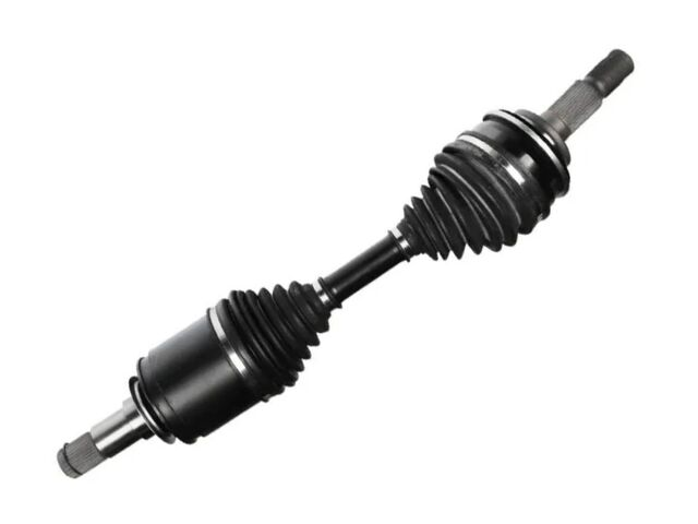

a reman'd axle is only 18$ with a 75$ core
i thot it was gonna be into the multi 100s for a new one
Remanufactured Front Axle | 2005-2015 Tacoma 4wd - Toyota (43430-04070-84)​
  • Sale Price:$18.53
  • Core Charge:$75.00
Maybe thats the total charge if you don't return the old one. When you do, you get the core charge back.
i plugged it into their order form to check that and no the total with that core was near 185$
with no charge shipping
Well I guess every dealer is inclined to make a profit. All I can think is, this might be a smaller volume shop that doesn't get the same deal the larger volume dealers would.

I saw the axles in person. The bearings are shot and have caused other damage. Yes, its early in the mileage. The only thing that may offer a plausible reason is the following. This truck was a farm truck that spent the bulk of its life on gravel roads. Gravel dust is abrasive and penetrates everything. The remaining grease in the boots was gritty with shiny bits.

CV boots?
i thot it was about a weeping front axle seal with gear oil oozing out?
pics are always helpful
Story is on these cv boots, they have grease in them....the grease breaks down, and the oil thats part of the grease composition separates, and oozes out.
