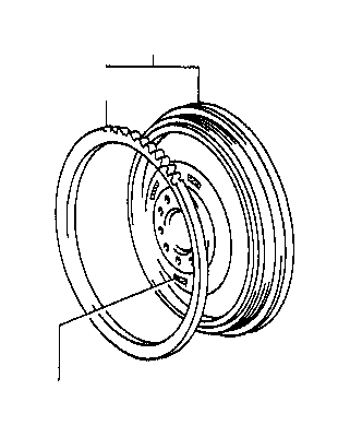

oh how here it is i found that flywheel part
512$ with the nIce 31 per cent discount
so i was told by a master Toyota repairman that it is best practice to replace the pricey flywheel, there could be pits and all that jazz
