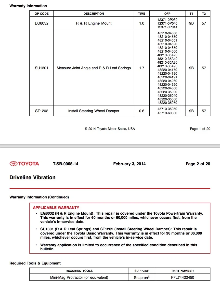

It appears... Toyota will cover this stuff under original warranties. Attached image is from 2014 TSB. Bugs me that leaf replacement would only be basic warranty. Sure, not part of d-train, but apparently the CAUSE of a d-train problem.
No mods other than tonneau cover and hitch. Tire changes but same specs, including snows that i switch in every winter. However they are on steel rims, if that makes a diff. 2014 tsb excerpt.jpg

Thanks whippersnapper
Has Toyota stated it's only about payload?
OR17, now I see your earlier point--that if this is about payload or something it could be straight warranty coverage, under applicabale warranty terms, not any included in a TSB.

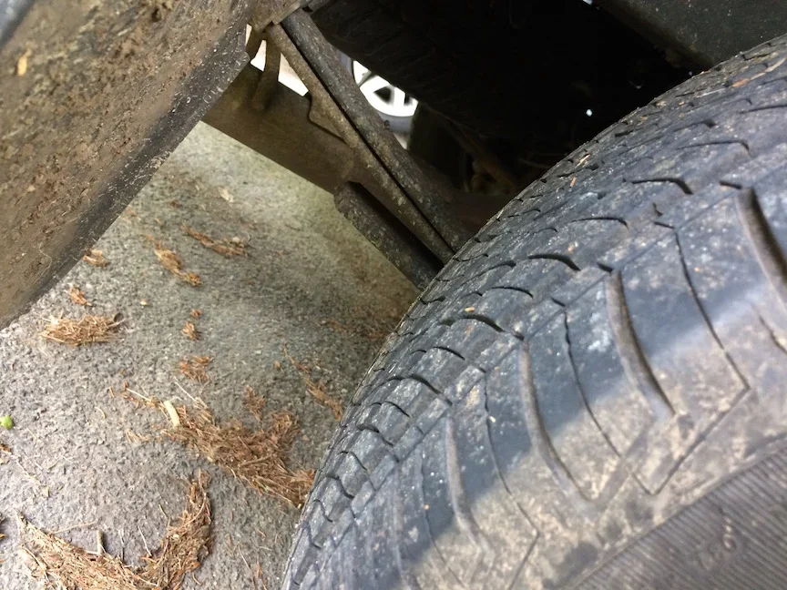

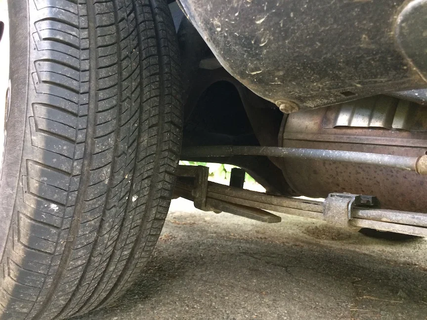

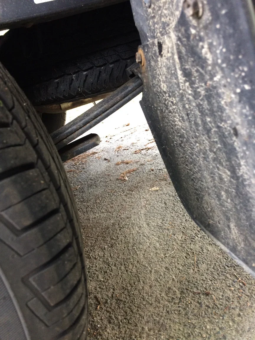

If anyone cares to comment: do my springs seem to have problems? I see what I'd call separation, but we already know my level of expertise.
Three shots: one from back of left, and both sides of right wheel.
