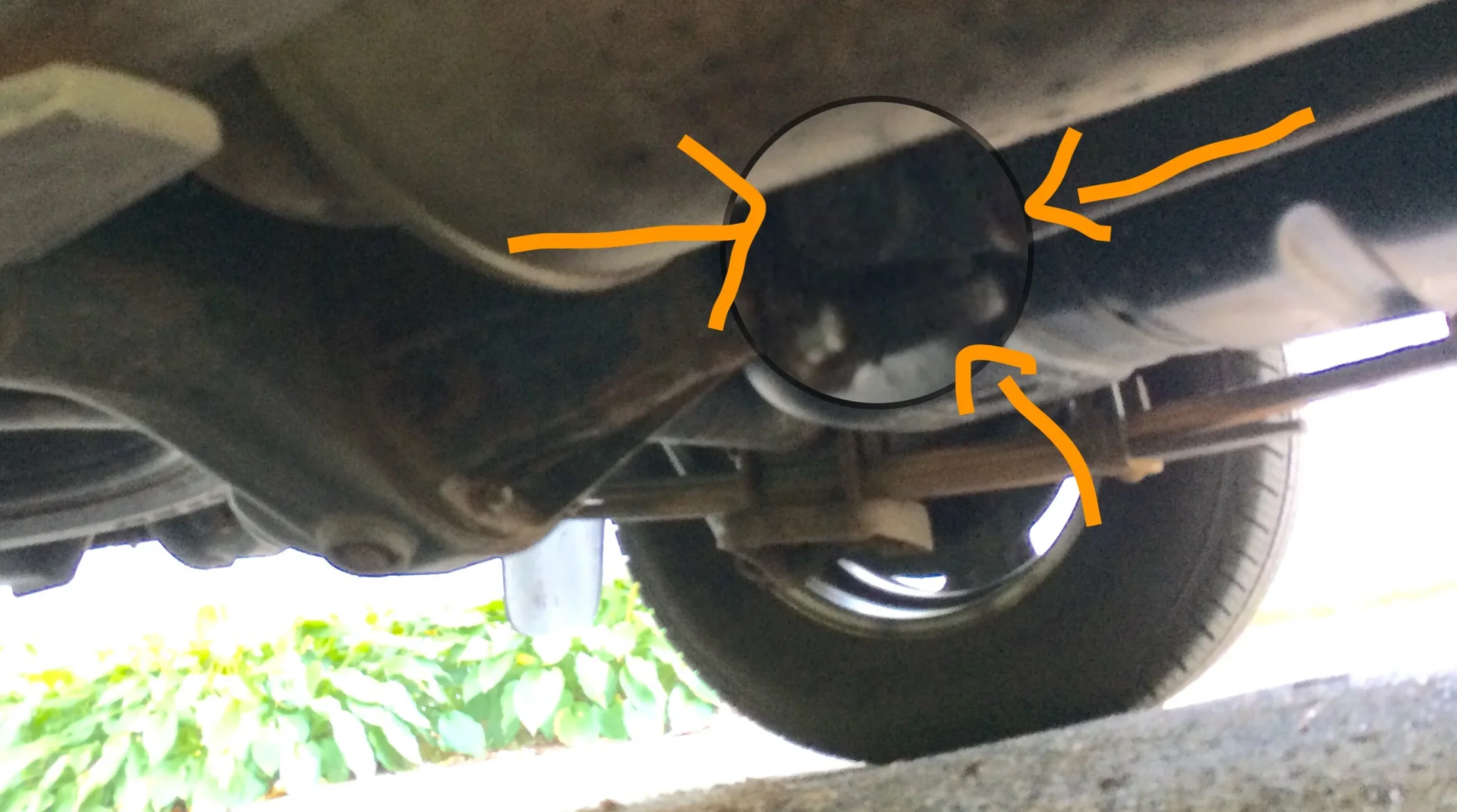

Since you are 4wd you will need to make sure the U joints are greased or grease them yourself. There are 5 in total...3 on the rear shaft and 2 up front.
It's 2wd ;)

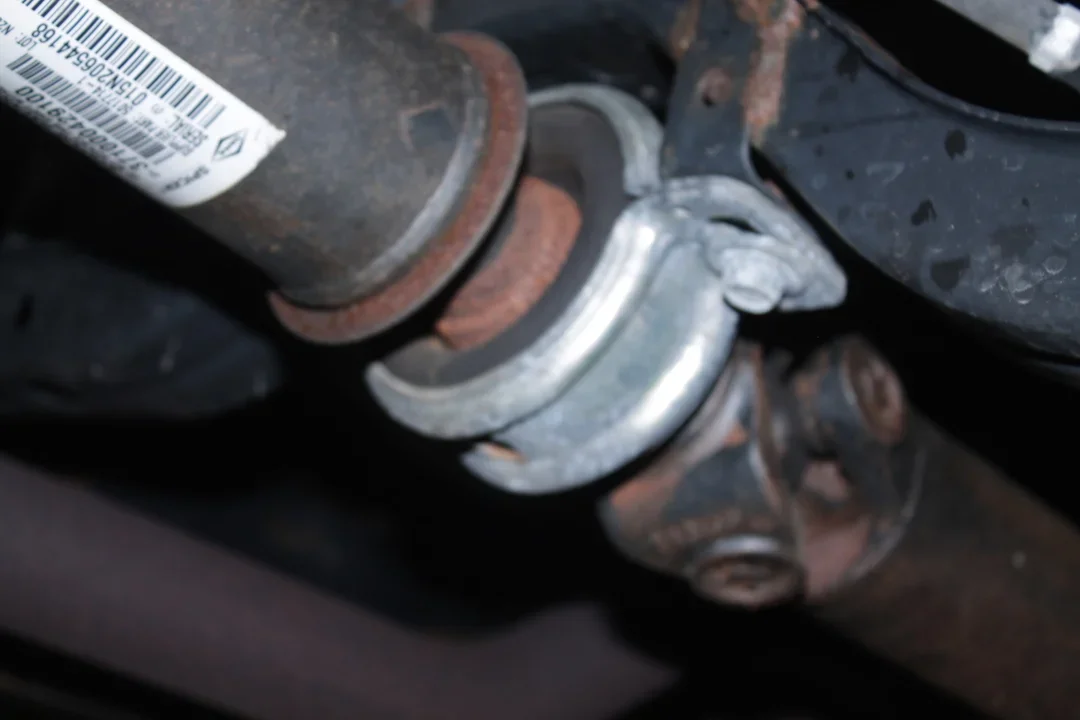

If you don't trust them take pictures or mark the parts with a sharpie. This is what you'd be looking for.
I've seen pics of modern u-joints, but not entirely sure of what I'm looking for under this (2wd) animal. !

I'm understanding this is the u-joint and only one.
Funny, that's the point i use to lift her with the floor jack.
NOOOOO. I'm not quite that stupid.
I don't trust them and ssso, would trust them to apply the necessary to remove sharpie. Is a little knife scratch here or there okay?

It's 2wd ;)

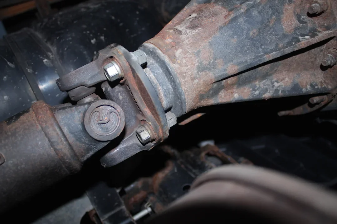

Looks, if they mean anything, and my gut tell me the rear diff joint is likely bad one...
If anyone is interested in fact/stupid/joint number checking me:

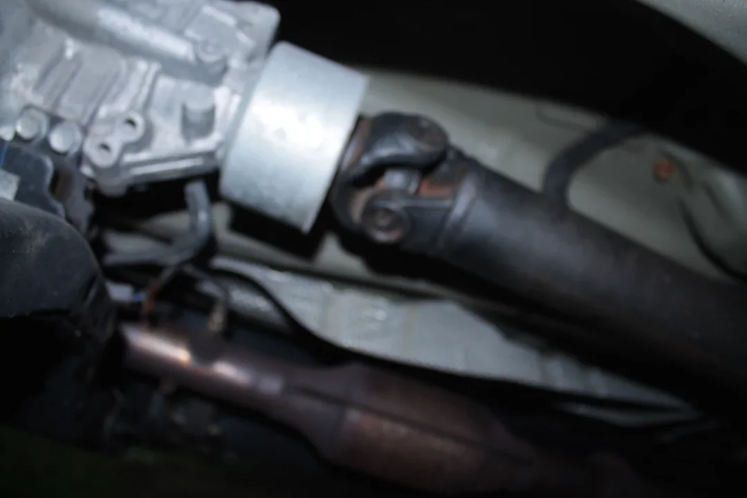

- Here's shot I got of transmission end u-joint:

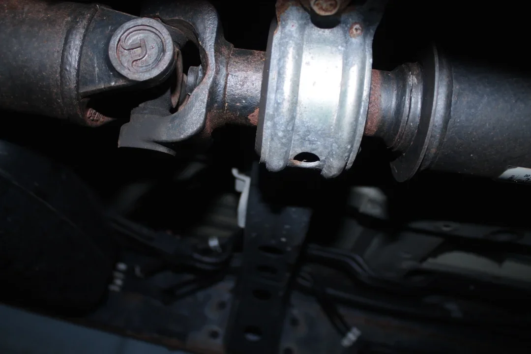

Mid-point, connecting 2 shaft pieces:
Two pics
I'm wondering how ( & why) a "2 piece" drive shaft with a carrier bearing does it without DBL cardan

Based on me immense knowledge the WHY is first 98% money. Could offer general corp calculus but you already know and I babble enough.
Confirmed rear joint. "It's called a u joint spider kit."
Ugly like photo means as much as Look lady at rust on your rotors. Need to replace them.

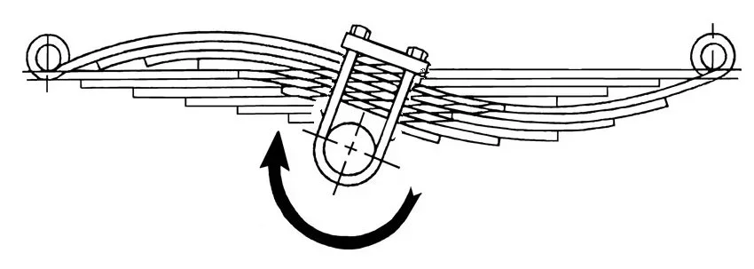

Diagram of axle wrap (or rather what spring is going thru during this condition... Under acceleration, condition replicates itself on deceleration to a full stop. It feels like a "thump" when coming to a complete stop...This is a huge problem that's going to continue until a new spring design is in place..
I get this in my 2017. First time it happens I almost lost it on the lady behind me because I thought she hit my brand new Tacoma. :mad:

Yep, too soft spring & not enough support for the shackle(rear) or hanger(front) ends , great for a cushy "car like" ride , but horrible once any mild demands are made, I hated that ****, felt like the 3rd./pinion was getting pushed & pulled where it connects to the diff, always felt like the truck stopped twice when coming to a stop.. haha this has been going on since mid 1995 (first gen begins)
Correction, up to1997 the tacomas leafspring was about 2" shorter i believe,which of course would give a firmer ride
