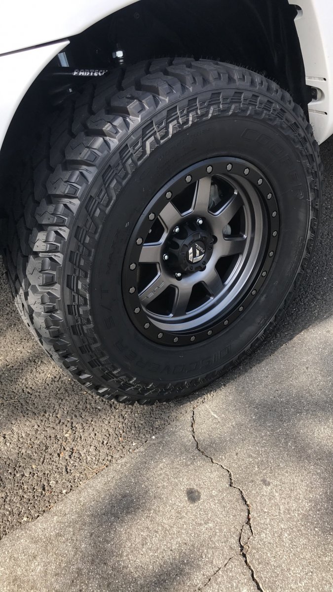

Im running nitto exo grapplers, had them since December or January. Haven't used them offroad and we didn't get any snow. But so far they ride and wear good and have really good reviews.Mostly for street but I do go to the sand and dirt sometimes. I’m putting a 3in lift

Yes, most tacos do. I can vouch for Total Chaos, good stuff. Haven't used any others. Try to get toe and camber to 0.00, a touch of negative camber doesn't hurt, -0.50 max I'd say.Toytec told me I would need aftermarket upper control arm to get more caster. My alignment now is .2 and .4 camber, 1.3 and 1.5 caster, .07 and .06 toe. first number being l/f and right number being r/f.
I run mine at 32-33.Running 36-38 psi
That's a good idea. Thanks Should do the test with warm tires I am guessing.Chalk test it. You should probably be at 29-31.
Did they sale you some UCA’s?Toytec just told me caster should be at mid 3 or between 3 and 4 degrees. They said only way to get there is upper control arms.
