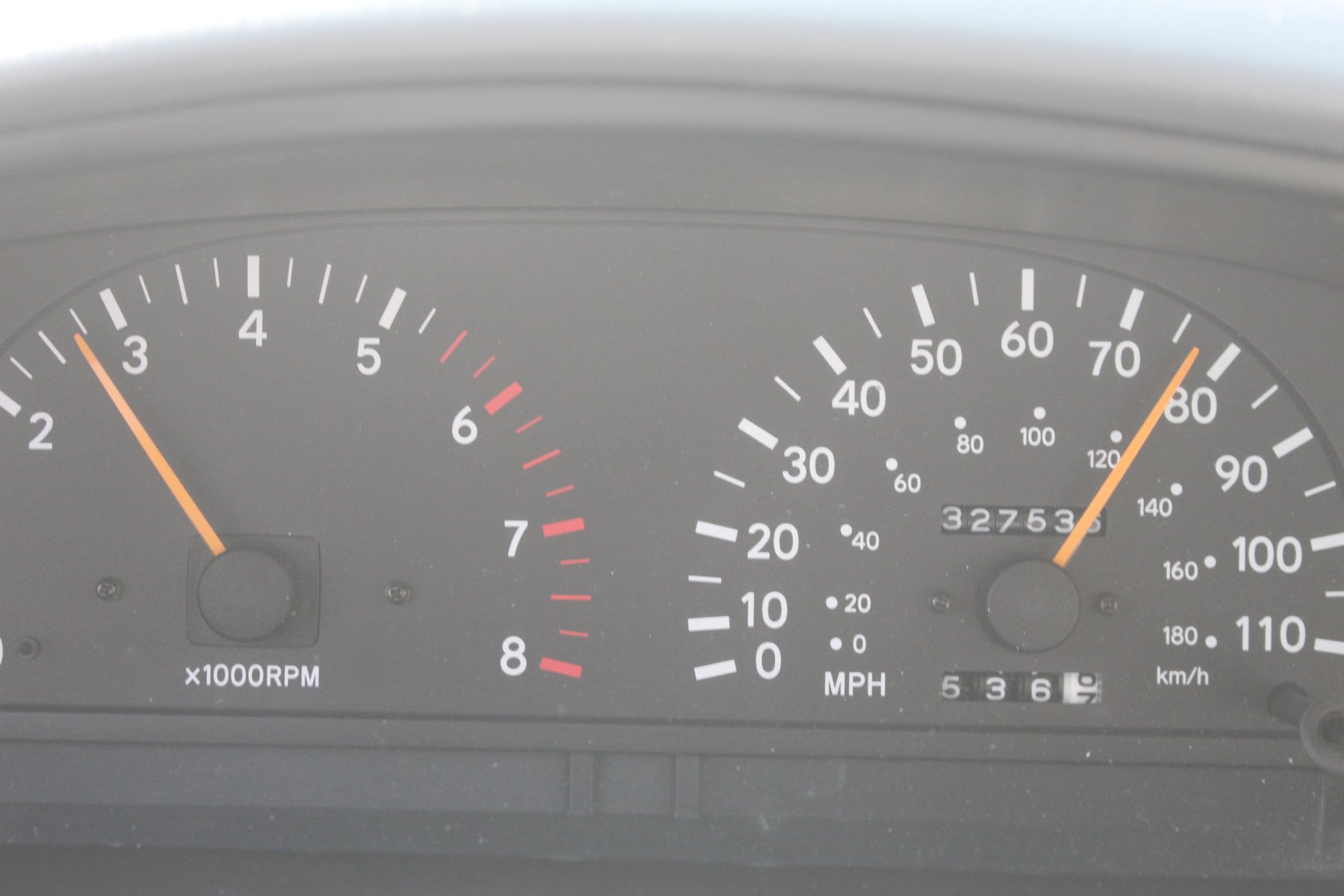

to check the specs... just in case this is an issue with the reBuilt
