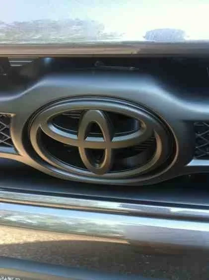

That's just the glare of the sun, all the chrome is dipped. You don't want to scuff or rub them between coats or after your done. Just let her dry about an hr between coats. Also use a toothpick to get the over spray between the letters and inside the letters off after 30 mins from final coat. Once it cures 3~4 hrs it's fairly solid. There is a slight gap between the emblem and your body, that's the 3M tape between the emblem and the body of the vehicle. At $5 a can I only used about a 1/3 of the rattlecan to do mine. Still holding up. You don't want to rub them after your done. Just powerwash them to clean.
Also avoid doing it in direct sun, windy & high humidity conditions. Only reason I went this route was I didn't want to debadge, paint then reapply badges. This stuff made it easy and I can always redo if needed in the future. I haven't jacked with mine since I done them and they still look the same.

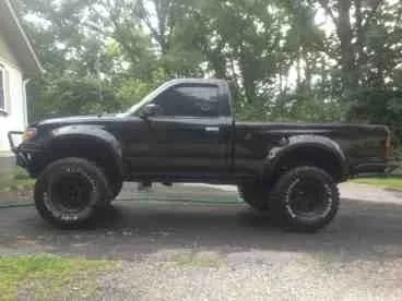

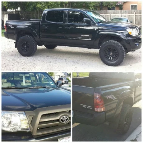

I plasti dipped my grill and my wheels. I take it 4 wheelin all the time and been in some pretty rough places and never had any peeling problems. Still looks great

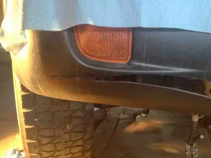

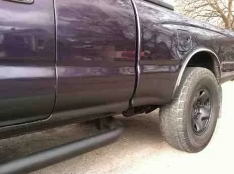

I sprayed the steps, wheels and about 4.5 in up the kick panels. I'm planning on doing the bumpers, brush guards next. Here's before & after pics. before ImageUploadedByTaco Forum1380085741.721678.jpg beforeImageUploadedByTaco Forum1380085837.055836.jpg after ImageUploadedByTaco Forum1380085875.276784.jpg

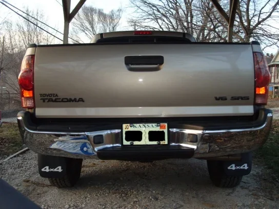

Post pics please. I am thinking about doing my steel wheels in that color. Not sure how it will look. Wanting to dip my chrome rear bumper. Just have not had the time. I dipped this last week. ImageUploadedByTaco Forum1380227871.654321.jpg

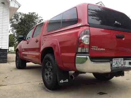

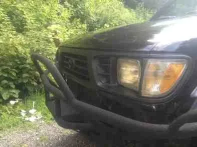

Did my bumper and front grille... no more chrome... for now. I'll peel it off later.

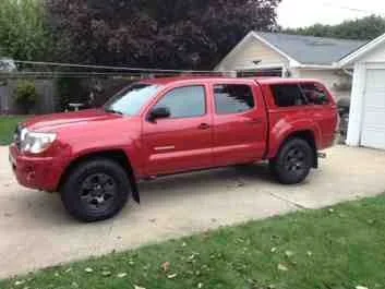

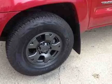

I was skeptical of the product but I was surprisingly pleased with the result. I looks great, works well I've had it driving around the past thunderstorms and some rough roads and its held up great. I respect everyone's view and some go for more permanent things but I see these rims lasting years the way it's going. Low price great look great results. What rim paint job can u get with $40 this good?
