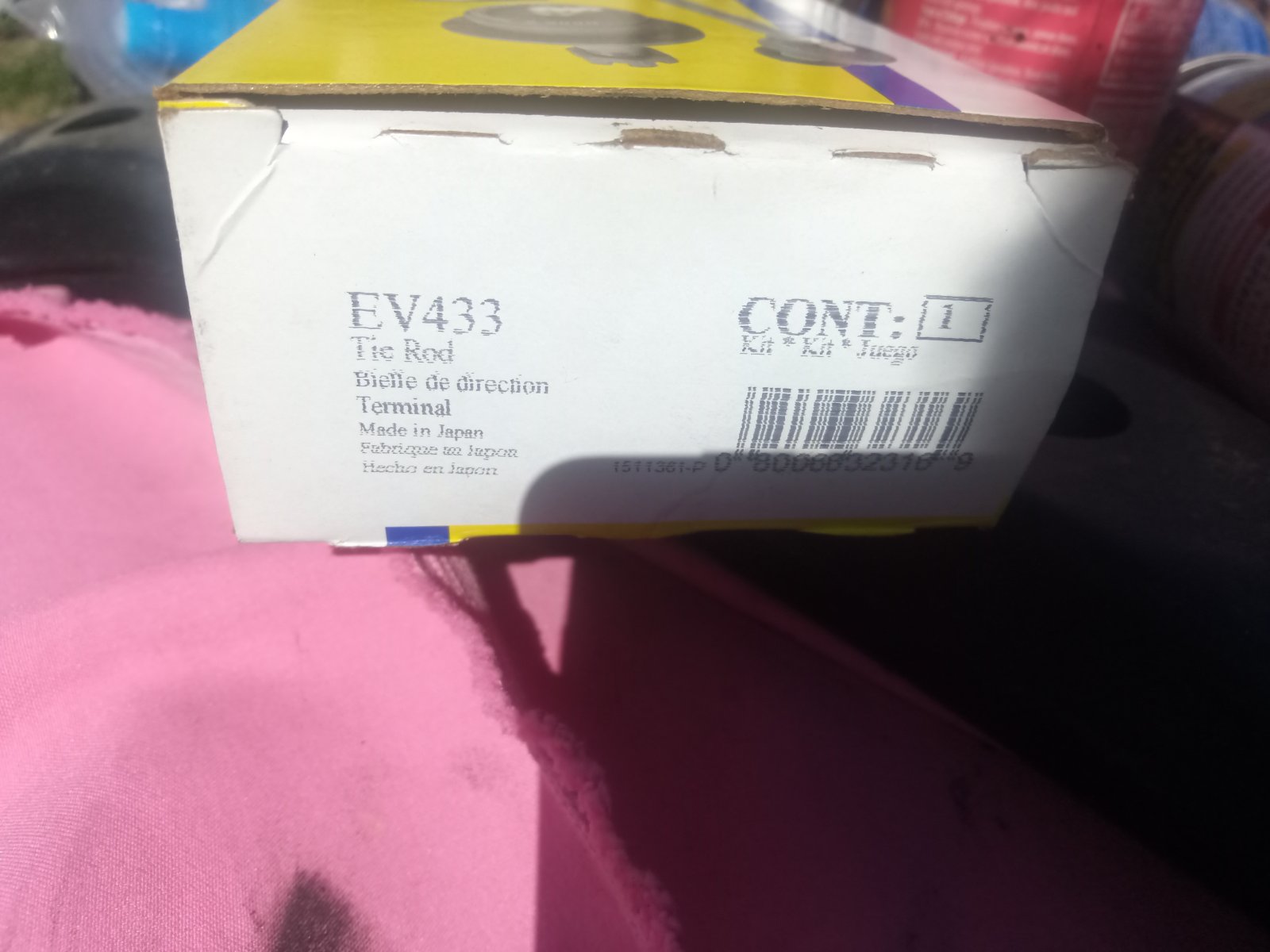

This Moog part is made in Japan, so perhaps it is a strict quality
