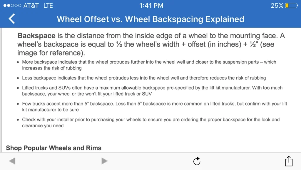

you sure about how back spacing works because im pretty sure you have no idea, just go with 4.5 it seems to be the normhttp://www.ebay.com/gds/Wheel-Offset-Backspacing-what-it-means-finally-/10000000009860383/g.html
also just wanted to point out that tou linked an article in another thread stating the exact opposite of what you said in this thread^^ you say more positive bs puts wheel further out and the article you linked says more bs(higher number) puts wheels further in hahahahahahaha Its cool man you just were being a smart ass despite being wrong no big deal thowHoly crap. Pink taco can suck it. Yeah, I was wrong. It is likely 5.5. Or right around there. However, tons of people run your mexi lawn taco set up. 4.5 bs with a 1" spacer is basically 3.5 bs right.
