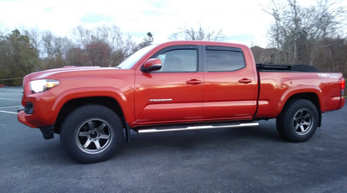

No lift...and 265/70r16. I love in the south....but am from New England. Last winter I went home they did great in the snow! I will be doing a lift shortly...and will be buying these in a bigger size....whenever I figure out what size that's gonna be lol
265-70-17 on 17x9 .
4.53 .Backspace offset -12.
Level 8 MK6. Wheels rub just a little on lower valance already trimmed with utility knife. No problem with mud guards. 17x8 might not stick out as far . no lift yet
265-70-17 on 17x9 .
Level 8 MK6. Wheels rub just a little on lower balance already trimmed with utility knife. No problem with mud guards. 17x8 might not stick out as far . no lift yet
0 or -6 offset you’d have no rubbing. -12 is just a little low for these trucks. There is a sweet spot for sure. Also an alignment can help put it in a good spot.
