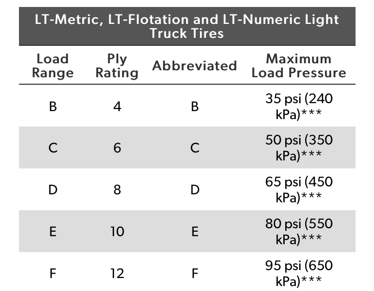

The C, D and E rating is for towing capacity or load rate. The E allows for more PSI and increased load rate. Advertising 2ply or 3 ply "rated" as 6ply or 10 ply is just the norm these days. They use to actually be 6ply or 10ply the industry terminology has stayed around. 35A07140-D20A-47CB-B138-C56423A44F24.jpeg

The C, D and E rating is for towing capacity or load rate. The E allows for more PSI and increased load rate. Advertising 2ply or 3 ply "rated" as 6ply or 10 ply is just the norm these days. They use to actually be 6ply or 10ply the industry terminology has stayed around. View attachment 17408
Right, its a throwback from the bias ply era, and determines the carrying capacity via psi and sidewall strength isnt it?

Thickness is different but the pic doesn't say if the ply ratings are different.
