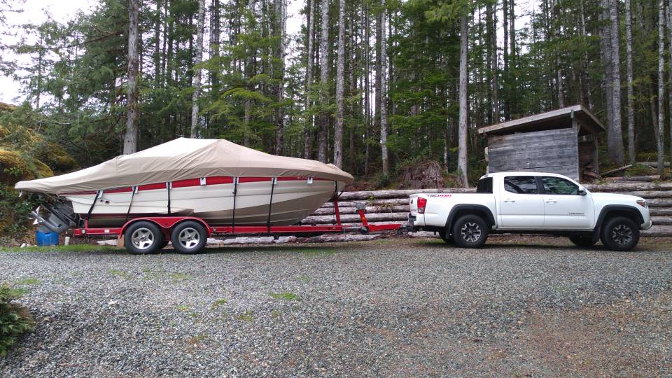

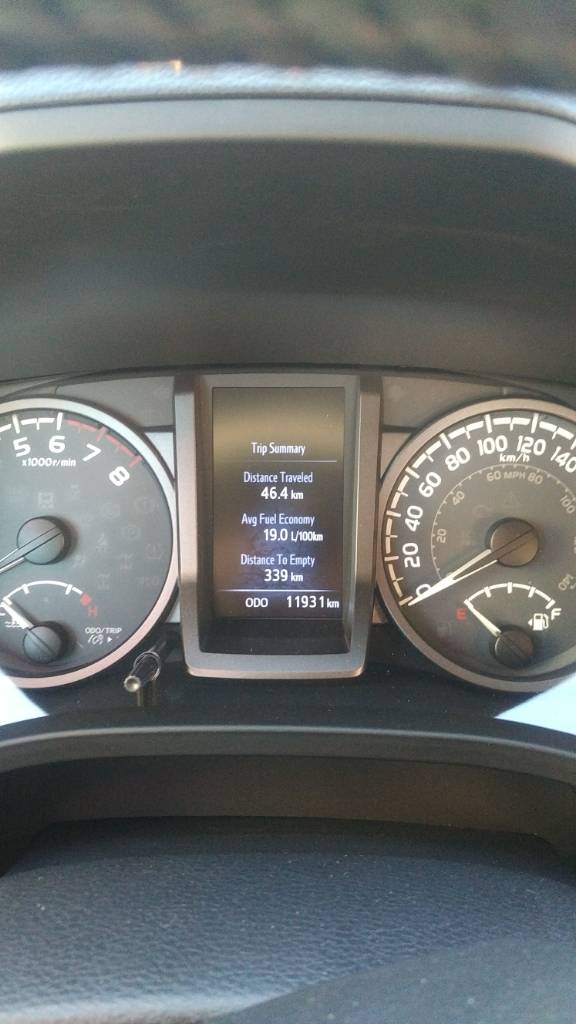

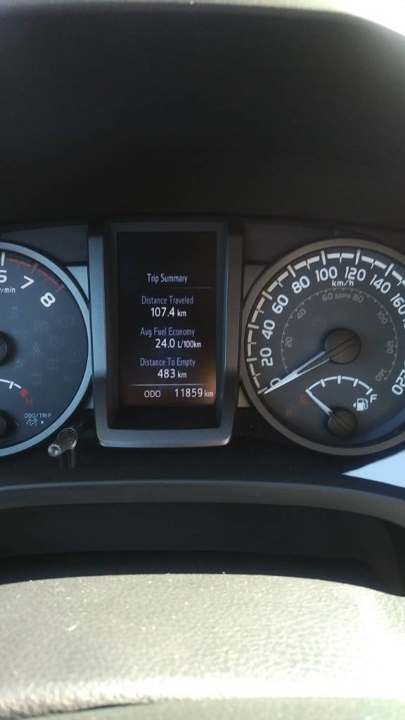

Frontal area, and aerodynamics, affect mpg when towing, more than the actual weight does. My empty enclosed trailer weighs just 3100 lbs, and drops my fuel mileage more than 4800 boat and trailer, or my equipment trailer with a skid steer on it weighing 11000 lbs I towed recently.
You are thinking about that right now I bet, and saying how can towing 11,000 burn less fuel than towing 3,100...
Because one doesn't push as much air out of the way as the other does.
In a panic stop they actually stop about identically. The equipment trailer brakes very well, the empty enclosed trailer brakes terribly, no matter where I set the brakes controller. Weight isn't the biggest factor when towing is my point.
Want to really suck back fuel, my Airstream travel trailer combines the aerodynamics of a brick wall, with a lot of weight, and really eats gas. But it actually stops better than my enclosed trailer does.
