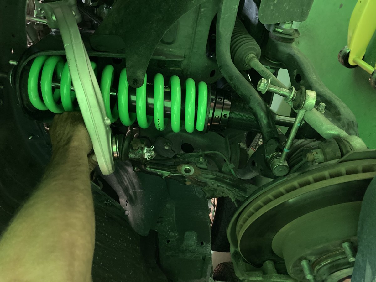

I just installed the toytec ultimate lift with adjustable 5100s in the front and 700lb coilovers. I also went with a diff drop kit to save the CVs. [emoji51]
Went with a progressive add a leaf pack and toytec aluma 2.0 shocks in the rear.
It gave me around 3 inches. So far I’m pleased with it. I paid around $1600 total.

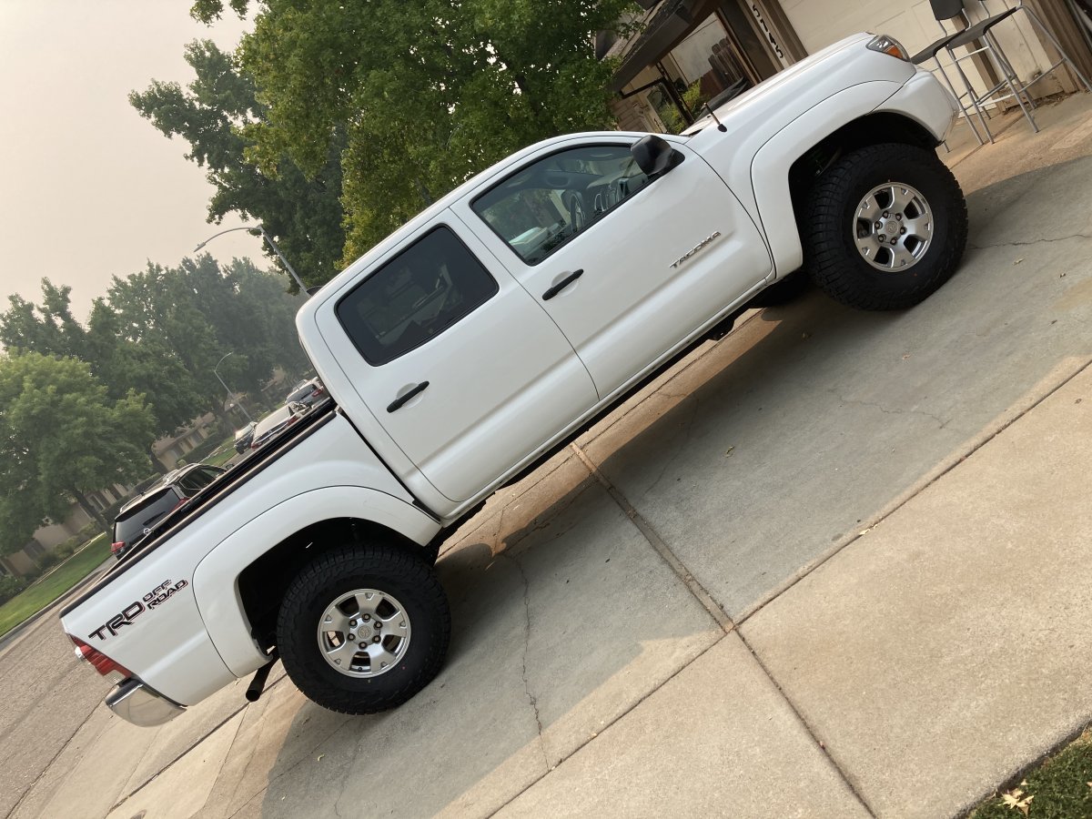

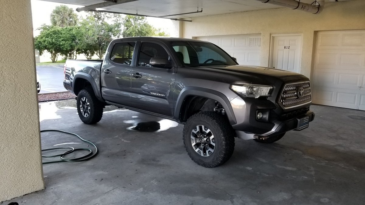

Here’s my ride. The install went fairly smooth, it has a smooth ride, no vibrations. I did install the driveline drop kit but not the front diff drop. I’m thinking I should?
I got 33’s on and got an alignment But it still pulls to the right some (though not nearly as much) I checked all my tire pressures so I don’t know what else can be wrong. Any ideas?

The truck looks good. I assume the truck didn’t pull to the right before the lift?

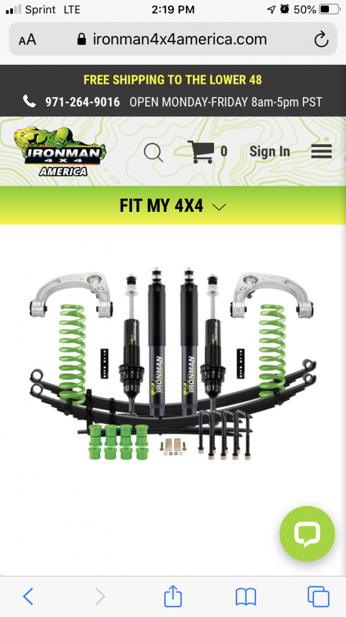

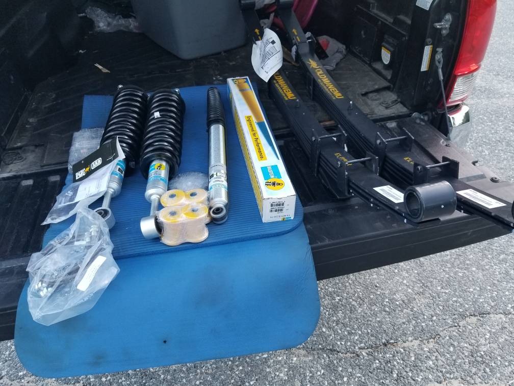

For the mid range Ironman is a complete lift. I went with the Bilstein 6112 front , 5160 rear with the icon add-a-lift . a front diff drop kit, sway bar re-location kit, and a rear drive shaft drop kit.
SPC upper control arms. Duro bump stops front and rear. 275/70/177028234A-2FE1-4150-8E0D-F1E75286710A.jpeg

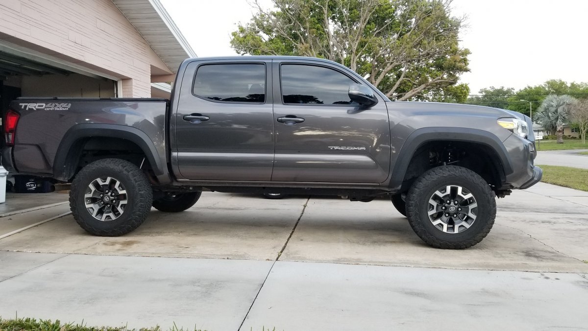

I have the R/C 3.5'' lift. I am super happy. Easy to install. My buddy a USCG Flight Mechanic and I did it over a weekend. Front on Saturday and rear on Sunday then took it for an alignment Sunday afternoon. I'm still using the factory size tires.20210930_180219.jpg20210322_185302.jpg
Your R/C lift , very nice. Vertex adjustable shocks, the way to go. The more I read about the Vertex shocks the more appealing it gets.
