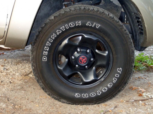

My 2¢ is I used real paint for my rims. I also used derp for my emblems. The derp was ok for them however, having 4 coats of derp on them and once you get any peel you have to peel it all off or you will have uneven layers. The derp is fine for the emblems since your working with a small area.
For the rims different story. I've had mine painted for 7 months now and only had one small chip the day after I painted, easy fix. Reason of chip, paint wasn't cured yet. Since then I have wheeled, drove down gravel roads, rain, mud, summertime heat and no chips, rims look great still.
As a matter of fact I just went outside and took this photo. Still look good.

I would go with 6 coats or more for protection against rock chips if using the derp. Also, let it cure a few days before driving.
When I painted my rims I used in this order:
2 coats self etching primer (rust-oleum)
4 coats semi gloss black (rust-oleum)
3 coats rust tough flat black enamel (krylon)
3 coats matte clear coat (rust-oleum)
Been holding up well since spring, winter will be the big test. Good Luck!
Edit:
Also my rims are steel w/plastic center piece. Yours look to be alloy so not sure how that will hold up. The derp might bite into the alloy better than it would steel.

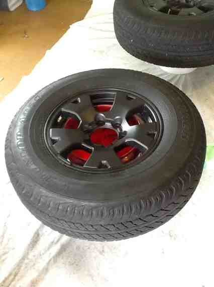

Hey Byrd. I was gonna go with 6 but saw that I wouldn't have enough. I think I went just a tad too heavy with the glossifier because I see a tiny bit of pitting. Maybe the 2nd coat of gloss will cure this. I'm sure not gonna peel anything off, now.

How did you get the center red?
I hope you let the derp cure 1st before using the glossifier. I didn't know they made this stuff and just read the info on it.

As for the red emblem on the centercap, that was no fun. However, I used play-doh. 1st I cut the bottom off a solo cup placed it over the emblem area and sprayed the red paint, 2 coats. Let it dry over night. Then put play-doh in the emblem area since it was recessed. Painted the centercap black using the paint I used for the rims and let it dry to touch and then took out the play-doh before it hardened. Afterward I sprayed 3 coats of matte clear coat. Took 3 times to get it right.
I would use a 2nd coat of the glossifier it would be like the matte clear coat I used. The more coats you have on each tire the better it will hold up to rocks.
