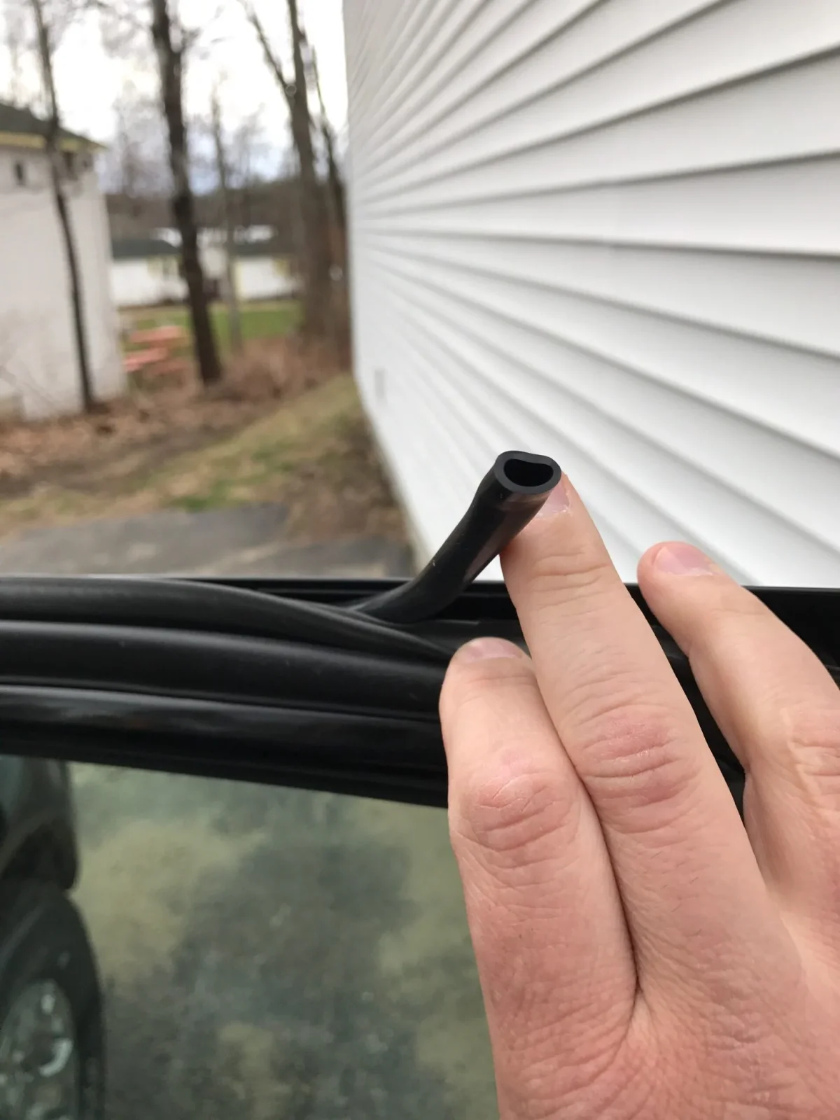

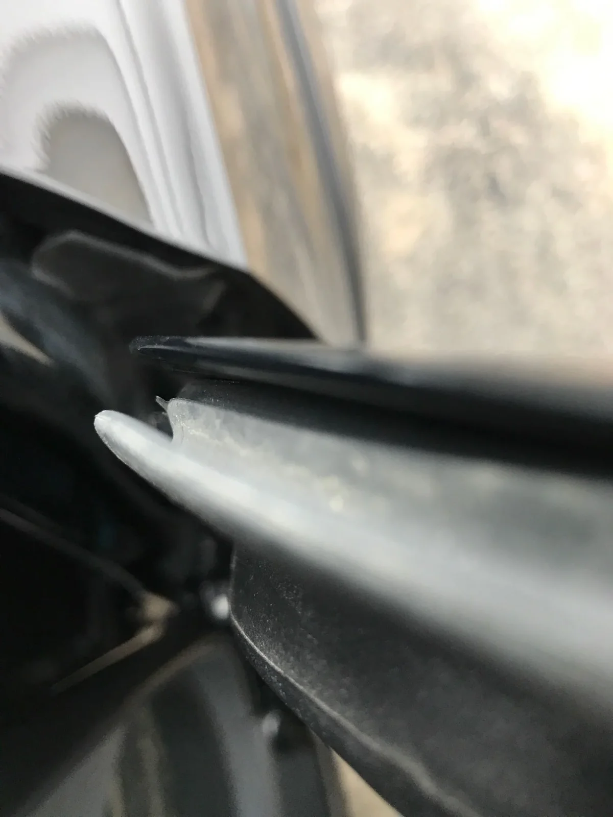

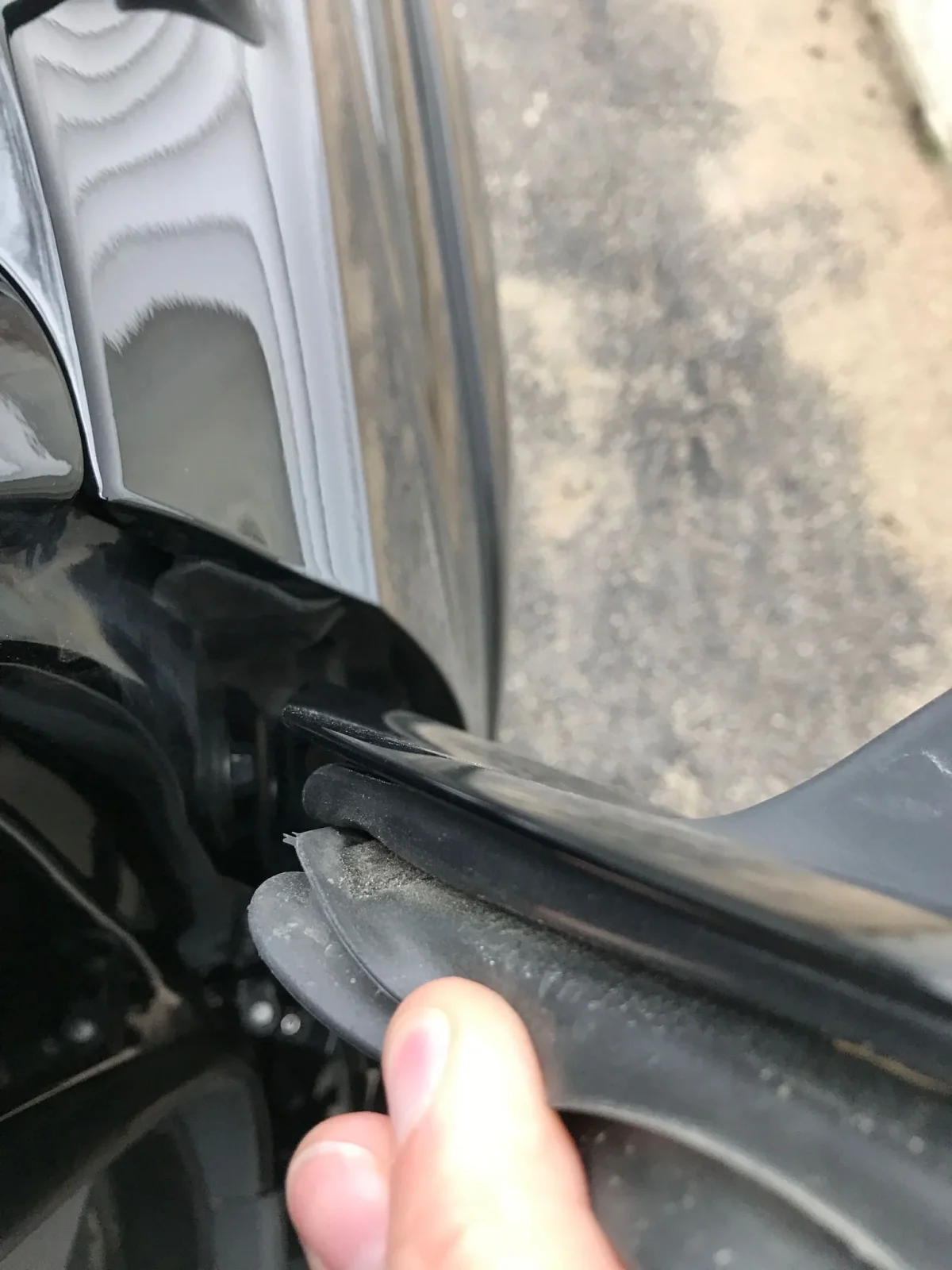

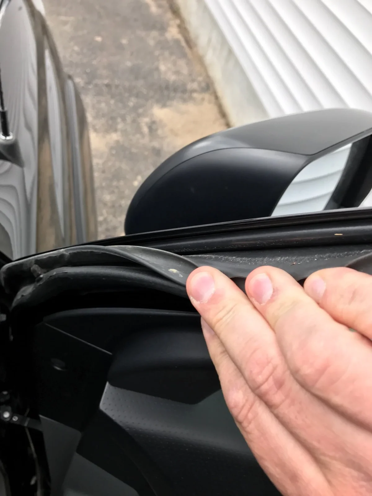

Guys I fixed this with 6 feet of windshield washer fluid tubing cut it into two three foot sections and put it between the door and seal you will not see it and it's a real fix. Honestly I took about 4 inches off each piece and it fit in nicely.
Kingsnap, would love to see a photo with details !!

This is the top corner it pinches the corner of my seal tight and you can see the hose is a little crushed.
Running down the a pillar to the front
A pillar again so you can see the run between door and seal.
How it looks relaxed and just sitting there. I am picky and I cannot see it. I have been in cross winds and what not no noise.
