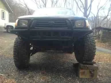

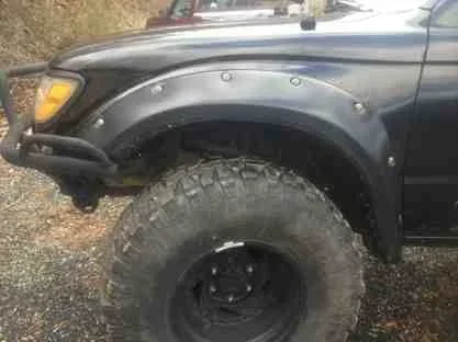

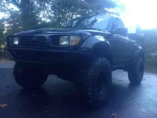

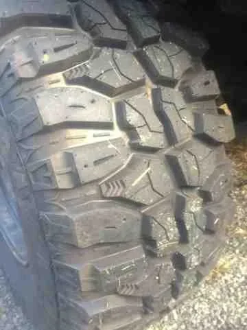

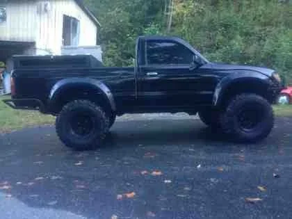

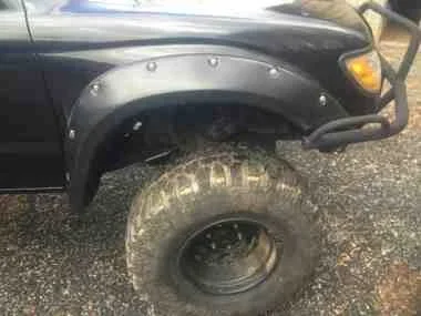

3in coil over lift with aal in rear, all pro front and rear bumpers rhino lined, bushwacker fender flares, plasti dipped wheels and grill, and 33x12.50 wild country mtx

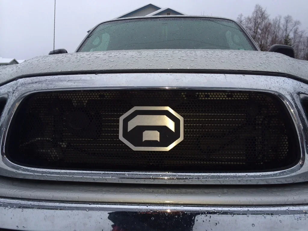

Painted Grill
Hello all, Just wanted to share mod I did this past week. I painted my chromed plastic grill gloss black with Krylon. I sanded the grill with 320 grit until the grill had no luster anymore. Then, cleaned with thinner or turpentine and sprayed about 4 coats of krylon. Waited about 10-15 minutes between coats. Came out pretty good. I'm very happy with it. Best to everyone this holiday season
That looks really good, nice job.:thumbsup:

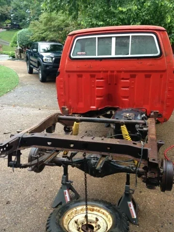

I seem a tacoma like my black one above and I noticed the rear shocks pointed towards the center of the bed. Does anyone know who you do this? Would you need longer shocks?
All depends on how you set it up. Unless you're doing alot of wheeling or something I wouldn't think it is Necessary, but here's how it's set up on my 79' ImageUploadedByTaco Forum1387509723.369881.webp the mounting point for the bottom isn't welded directly to the axle, but is on a bracket connected to the axle. So if you wanted to do it yes you would have to make new mounting points
