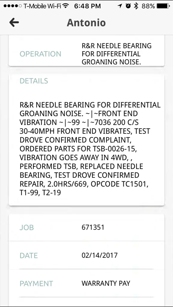

    Happens to me too on my 2016 Tacoma, warranty cover everything.. I just paid $95 to parts for the ECGS.. put 1000 miles since they did and is a big difference. Not noises or vibrations.

  7. bestantonio
    bestantonio Well-Known Member
    YES They all ready know the TBS
    They did recommended the aftermarket part.. and I paid for that only.. the ECGS... they told me that when they do the lift for customers they recommend to do that!!!
    This is what is in my records.
