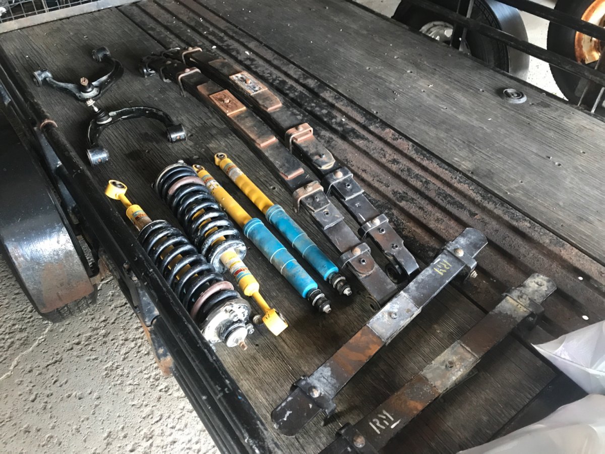

    So I had a buddy pick up these parts from Ohio last week and the rear leaf pack looks a little beefier that what’s on my SR5. When I look underneath my truck I see 4 leafs and this set up has 6 in the pack with out the AAL. Here is a photo of what $200 got me Now I’m not 100% sure I’m putting in these upper control arms since they look identical to the ones on my truck already so that seems senseless. But everything else looks pretty good to me and it’s cleaned up pretty well too. I may not put in that AAL that off to the side in the photo. 58224347738__84178C32-B1BE-4090-9C5F-018FAB3EE53B.jpg

  16. Crawdad
    Crawdad Well-Known Member
    I think those packs actually have a progressive 3 leaf AAL already installed... maybe @kp.taco can confirm?
    The 3 smallest leaves look different and there's an extra guide bracket or whatever they're called on each end...
    ricej90 likes this.
  17. kp.taco
    kp.taco Well-Known Member
    Yeah it's for sure some kind of progressive AAL
    Crawdad likes this.
