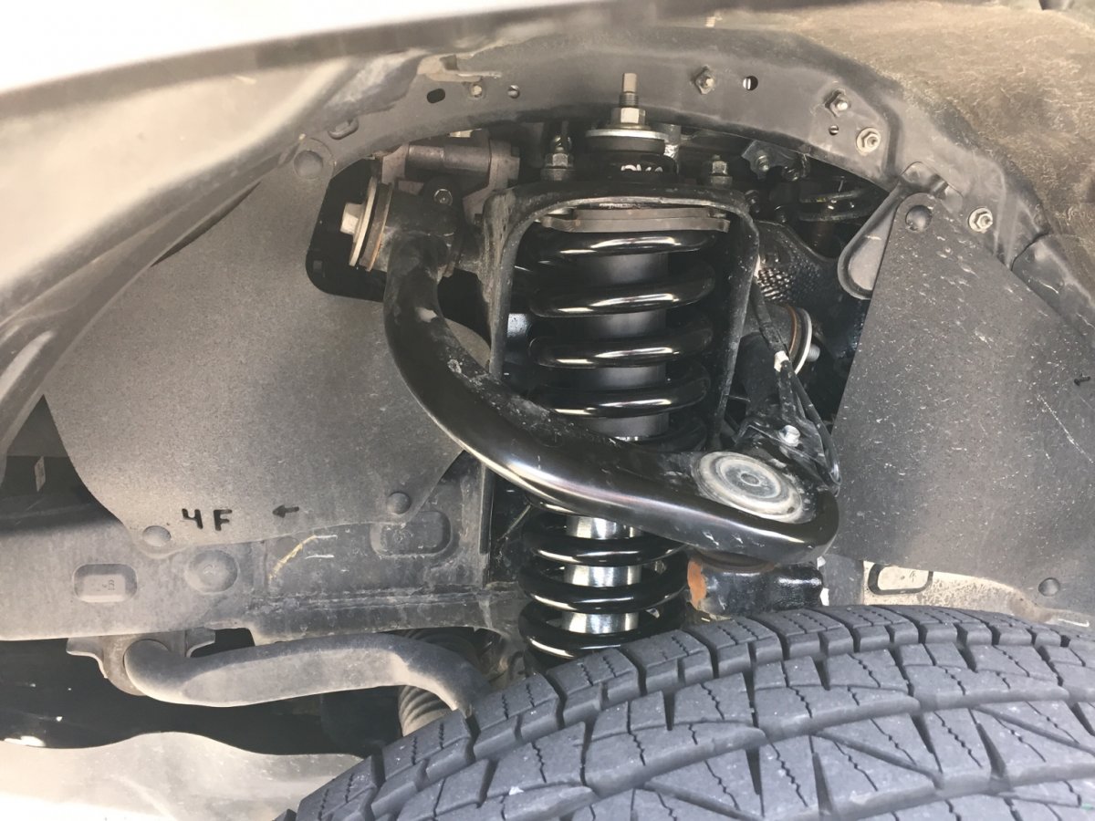

    What got me both times was the front coil assemblies.
    If you have the option, maybe with a different vendor, order your front coil/ shock as an assembly.
    My kit calls for the re-using of the factory coil assembly top.
    What I found to be the issue is that the aftermarket coil compression tools avail will not fit between the coils to disassemble - and if you do manage to squeeze one in like I did, you won’t be able to get it out of the new coil because your compressing more coil into a smaller space for the Bilstein adjustment.
    I rented the 2 side compressor tool but it didn’t work, I bought a giant clam clamp, but again the hooks to hold the coil wouldn’t either fit in to disassemble or I couldn’t get them out once the new coil was assembled.
    I even tried a external hook style hydraulic one but it kept slipping off the coils and almost making me crap my pants.
    So I suggest an assembled assembly or if you have a off road shop near that can do it for you, but keep in mind that requires a second vehicle or a friend for a ride.
    So far my “mistake” has cost me an additional $340.
    $150 for a new shock cause I ruined the threads when the coil popped off during a failed assembly try.
    $100 for having the factory coil assembly put back together cause I ruined the shock above.
    $30 for bay space at my local military installation auto hobby shop.
    $60 for the clam clamp that didn’t work.

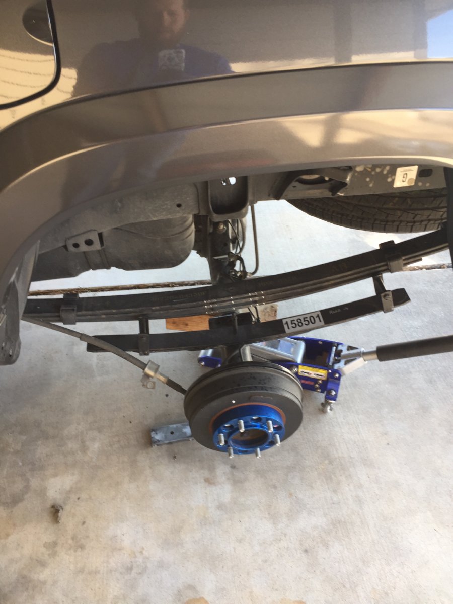

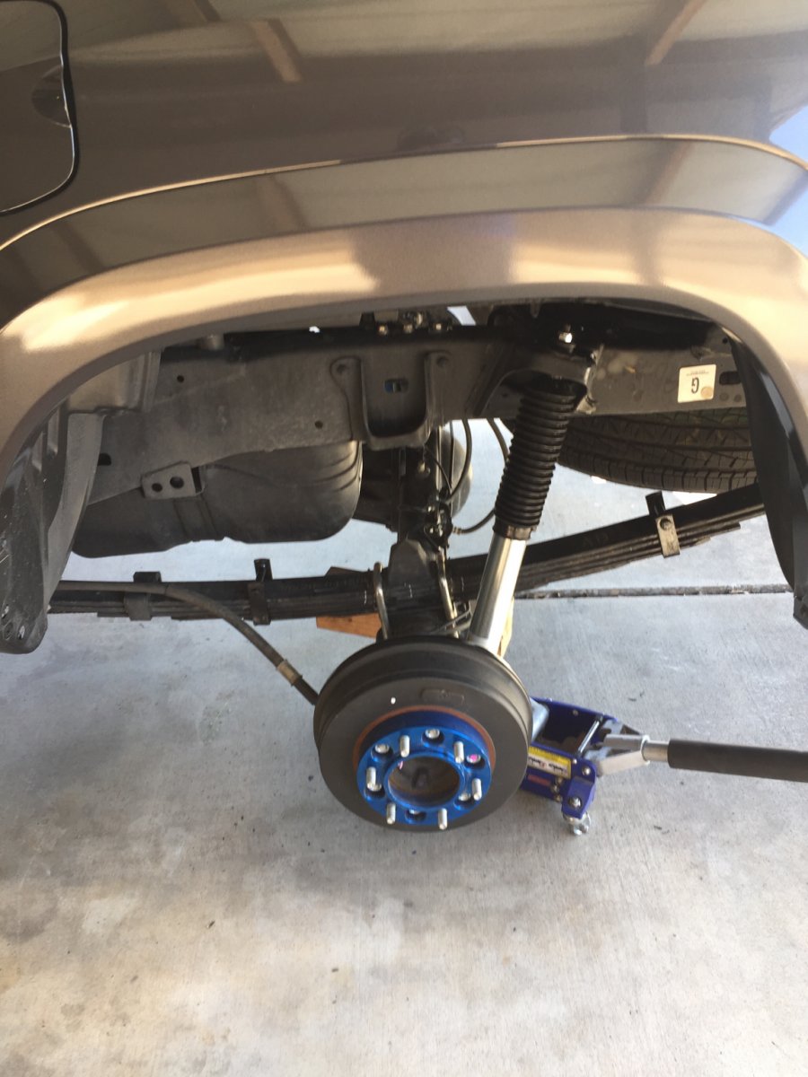

    The rear is done.
    From breaking lug nuts to putting it back on the ground took 2.5 hours (there were breaks taken so probably about 2 hours total).
    Driver side first.
    This side is harder cause the brake lines only let you sag the axle so much, but it will go on, just be patient.
    I took apart, removed the shims and re-greased them.

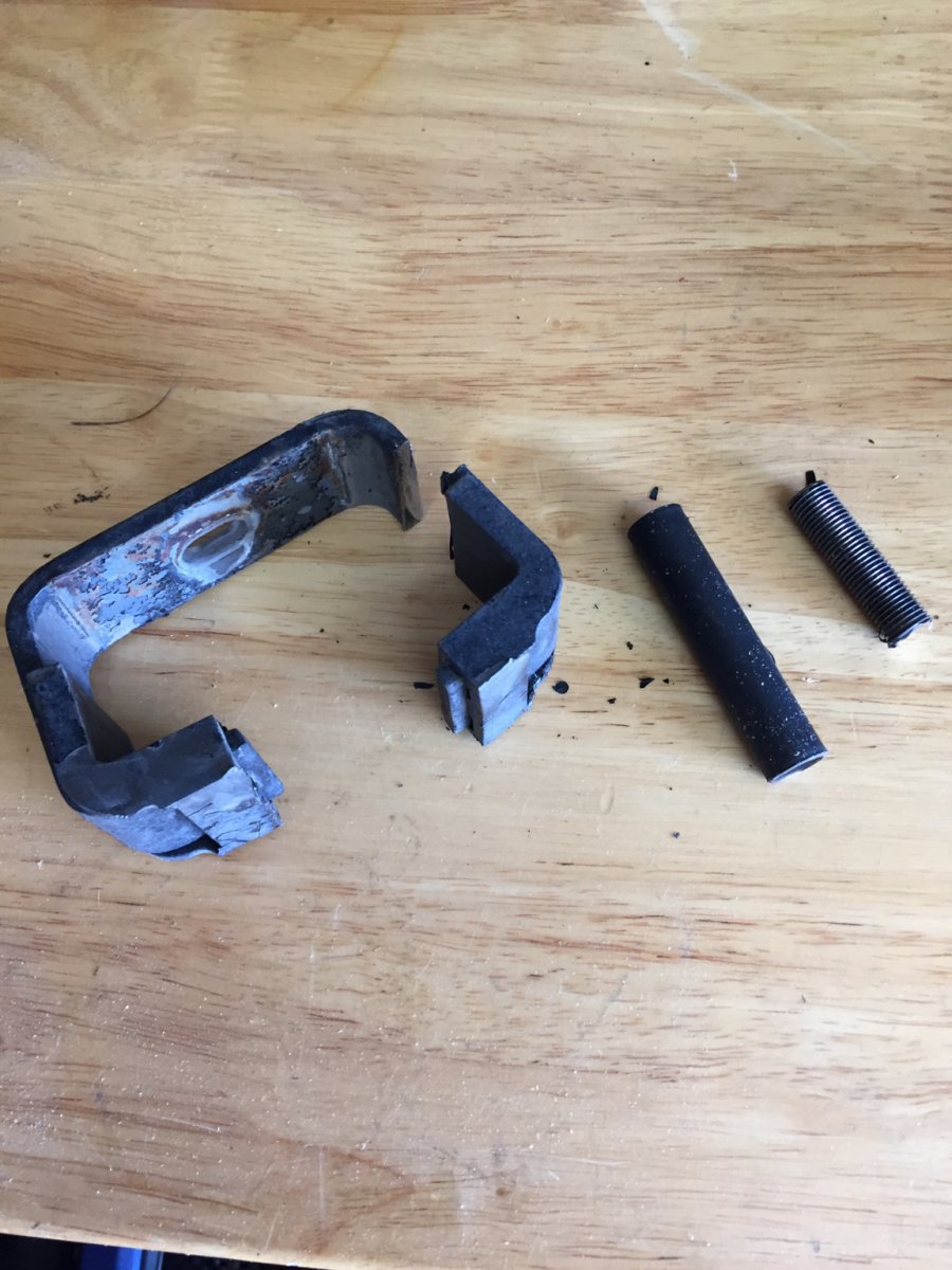

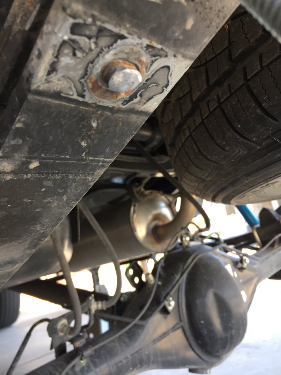

    As far as removing the rear factory leaf spring clip, I ground off the bolt head, cut the clip and tapped with a hammer to remove. The remaining stud would not pound out for me, so I ground it down and smoothed with a flapper disc, painted and left it as is.
    The directions say to pound it out, mine wouldn’t budge.
    Passenger side took less than 45 min.
    Put the nut back on the leaf pack stud & tighten before you trim it. You may be tempted to cut it first, especially on the driver side - don’t cause you may mess the threads up and you may cut it too short.

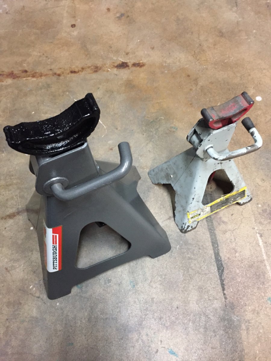

    I also used 6 ton jack stands because the 2 ton stands were too narrow in my opinion and left the truck feeling wobbly as they were at their most extended range to have the truck up with enough room to drop the axle.
    Here’s the pics.
    First 2 are the differences between 2-6 ton jack stands.
    The clip stud that was ground, cut, sanded, painted.
    The new leaf up to the factory. Not a lot of room there to get that long bolt in.
    All done. One more side to go.

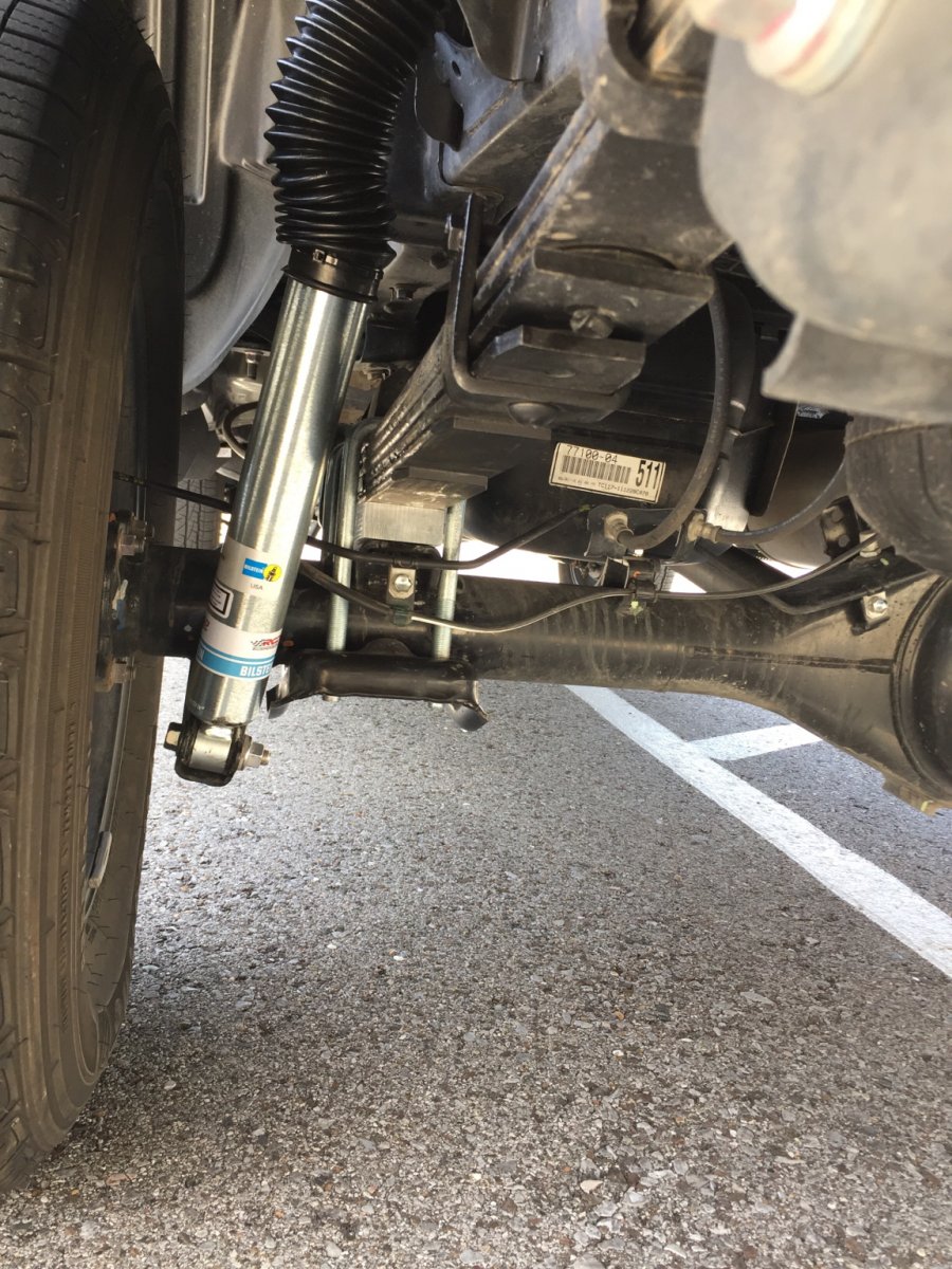

    Here’s what your left with for one side.
    The cut leaf pack clamp, the extra thread from the new AAL bolt, and the thread protector sleeve on the AAL. IMG_1554059410.812569.jpg

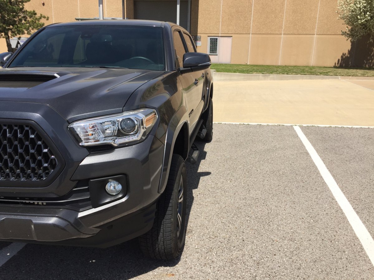

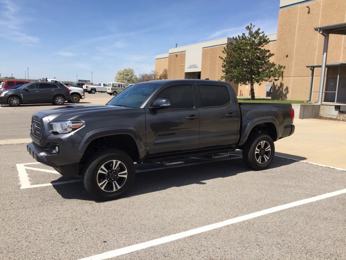

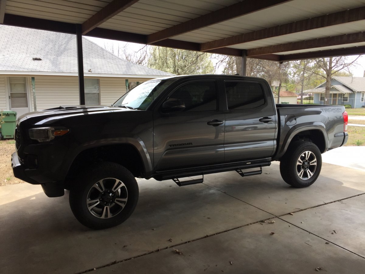

    Before the lift:
    35 1/4 front
    36 rear
    After the lift:
    38 1/4 front
    37 1/2 rear
    I only went to the 4th position on the shock which is 1.55” lift.
    So now the front sits 3/4” higher than the rear.
    I am going to give it a week or two and see if it settles.
    If not, I did get the 1” blocks when I ordered my kit, I may install those to fix the nose bleed.

    Grey18Taco
    Grey18Taco Active Member
    I ended up putting in the 1 inch blocks in the rear last night, it now sits a quarter inch higher in the rear than the front.

    It was 1.5 with the Icon AAL which brought the rear from 36” factory to 37 1/2”.
    Then I added the 1” block as the rear was 3/4” higher than the front.
    Now the front is 38 1/4 and the rear is 38 1/2.
    kp.taco likes this.
