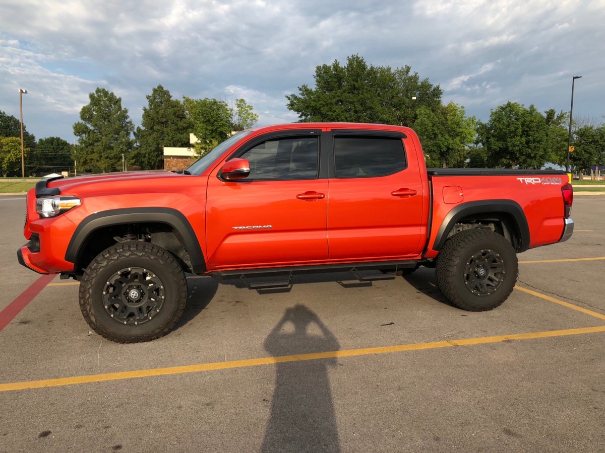

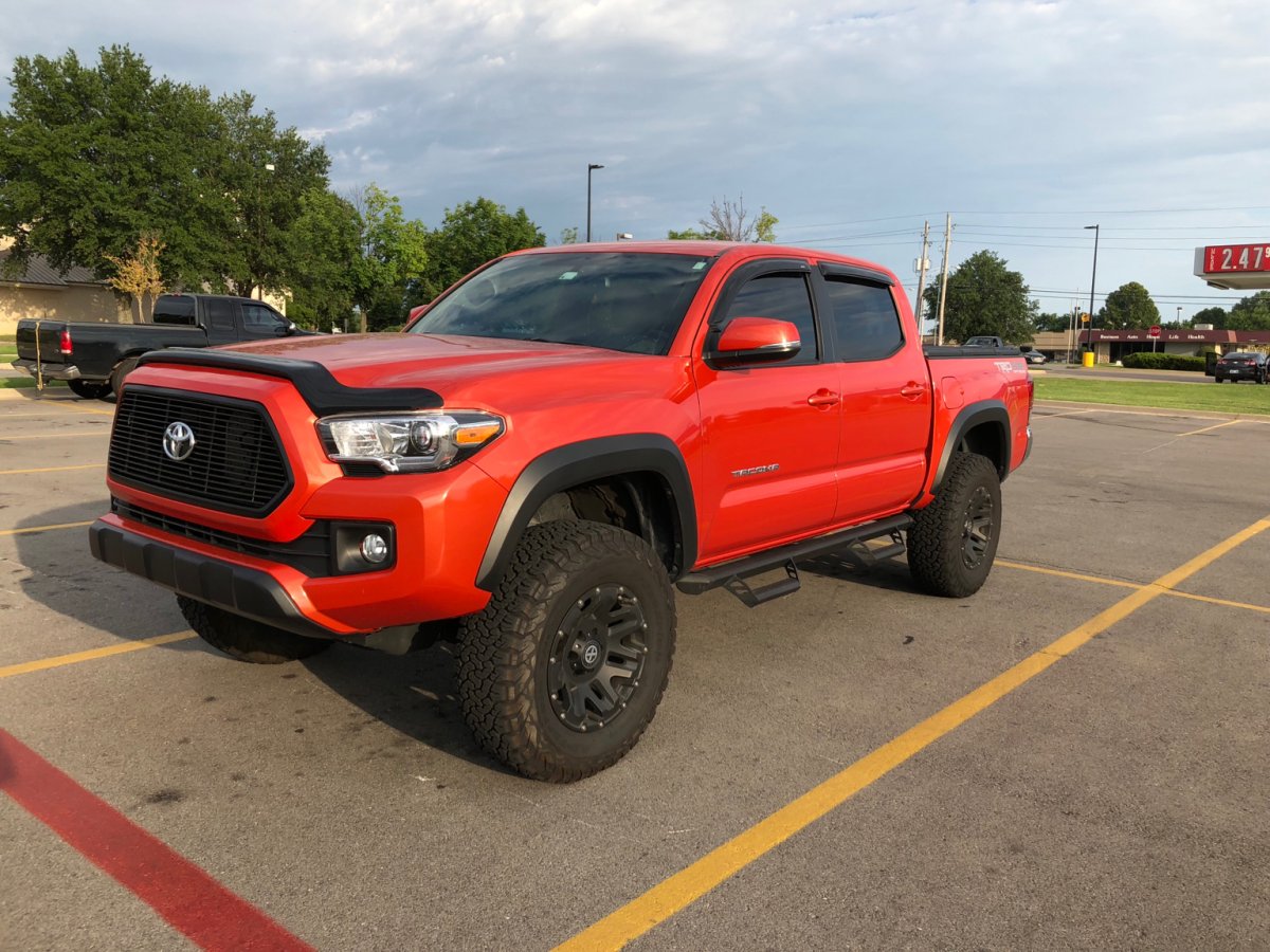

    Should I change to a 285/65/17? Would that fix the problem ?
  3. OR17TRD
    Currently you have
    285/70/17 = 32.7x31.2
    285/65/17 = 31.6x31.2
    If they make that tire size in your tire you would loose an inch of height.
    I would change the rims to have the right back space and offset.
    A rim with a 0 offset or a -6 works well with the 3" lift and 285/70/17.
    I have 285/75/16 with 3" with -6 offset and if I hit a hard bump and I'm turing into it I'll get rubbing still. I know what it is and where it's happening but it doesn't bother me.
    Let us know what the Tate bro's say about the wheels.
  4. OP
    TacoGal
    TacoGal Well-Known Member
    I found my paperwork (finally) and the rims have -12 offset
  5. OR17TRD
    That's a little more than I would have gone. I have almost the same set up my tires are 0.1" taller than yours but your -12 off-set will push the tire out 0.25" further than my -6 offset which might be causing more rubbing when turning and hitting bumps.
    I'll get rubbing when I'm turning at higher speeds into a hard bump. If I go slow I don't get it. Changing my driving habits some reduced the times I get rubbing. It doesn't bother me when it happens because I know what it is and why it happens.
    You can either get a rim with 0 or -6 offset, decrease your tire size to 285/65/17, heat and mold the wheel well or trim it more or you can change your driving habits and live with the occasional tire rub.

    This off-road place said I should get +18 offset .... sounds drastic
  7. OP
    TacoGal
    Tate Boys is going to get me new rims with 0 offset... fingers crossed that works
    OR17TRD likes this.
  8. OR17TRD
    Yeah that will put you 1.18" closer to the UCA. Or .12" closer than stock it might be ok but you won't have the look of the wider stance. If that's something you are trying to keep.
    TacoGal likes this.
  9. OP
    TacoGal
    I realized I never replied back. So with my new rims at 0 offset, everything works now. I've heard no rubbing since I made the change. Thanks for always helping me
    Dread and OR17TRD like this.
