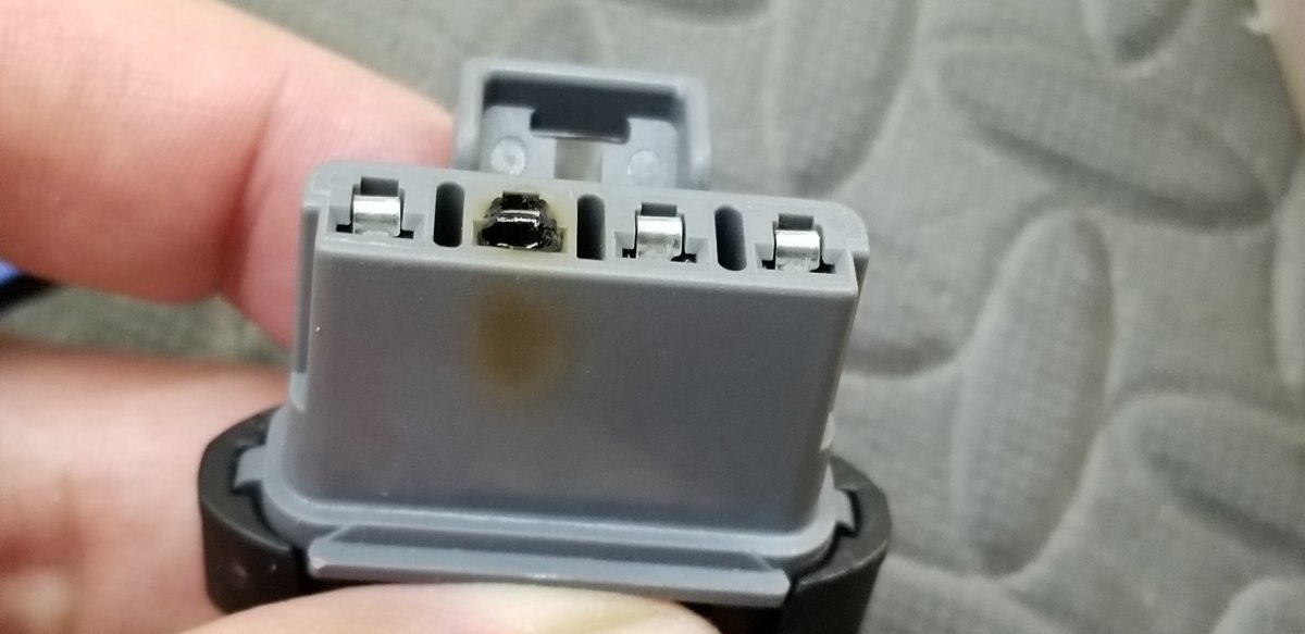

Well yesterday the trucks ac blower only worked on high.
Great.... sent a PM to the Nancy, and got hooked up with a link to replacement parts, and instructions.
Amazon.com had the parts here today and they have already been installed. Ac blower works on all settings now. My resistor was indeed scorched a bit, and the connector on the other side was worse

Parts...
https://www.amazon.com/dp/B01JJ5KAVA/ref=cm_sw_r_cp_api_aM5qBb5MTZCKN
Writeup someone did
https://www.tacomaworld.com/threads/replacement-of-hvac-blower-motor-resistor.8310/
