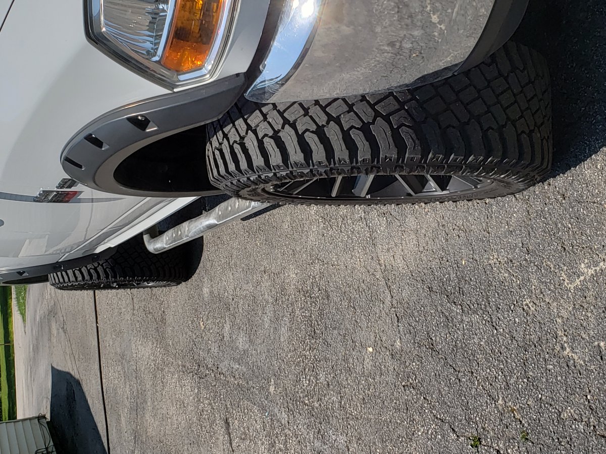

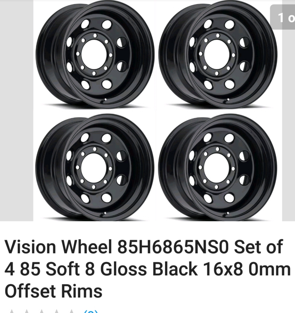

    With these rims?

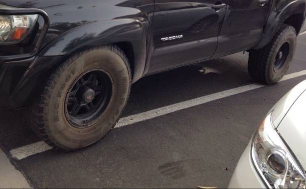

    U want wheel spacers then.

    So those rims with the 4.5 b.s. would definately give me the look

    Yeah rims. Stock wont cut it unless i get spacres correct?

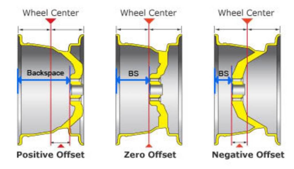

    Here's a pretty good picture of what Jangly was explaining. 20180704_105330.jpeg
    OR17TRD and Bojangles like this.
  11. Bojangles
    Bojangles Well-Known Member
    New rims will work.
    Spacers are about $200 a set of 4 i think.
    Ur call

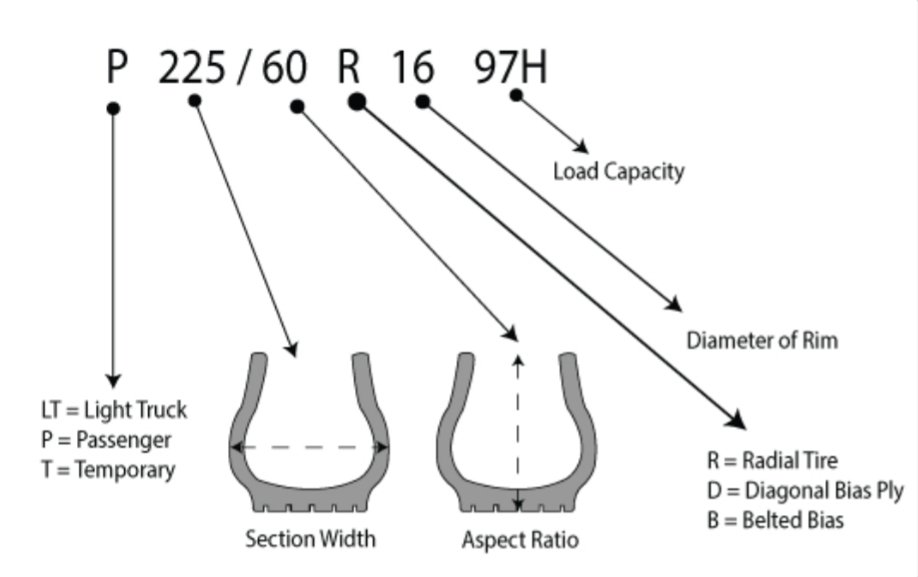

    So, in a nutshell....those rims with 4.5 bs will give the desired look without spacers.
    The tire size that will accomadate those rims would be?

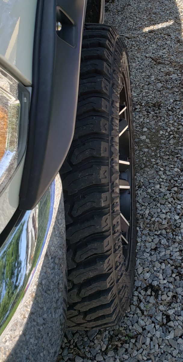

    This is a 16x8 4.5 BS "0" offset but that's a 285/75R16 with 1.5 lift in the rear. Is that what you're looking for? 20180704_110044.jpeg

    Does that extend out past rim? Its hard to tell.

    You'll have rubbing issues if you try to stick out too far.

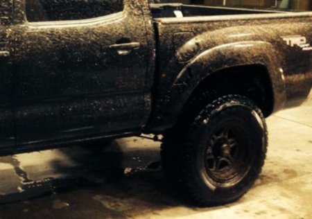

    Heres the perfect look(again, maybe not as dramatic extention)
