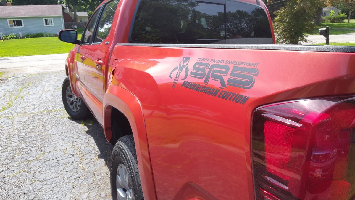

    Heres my truck

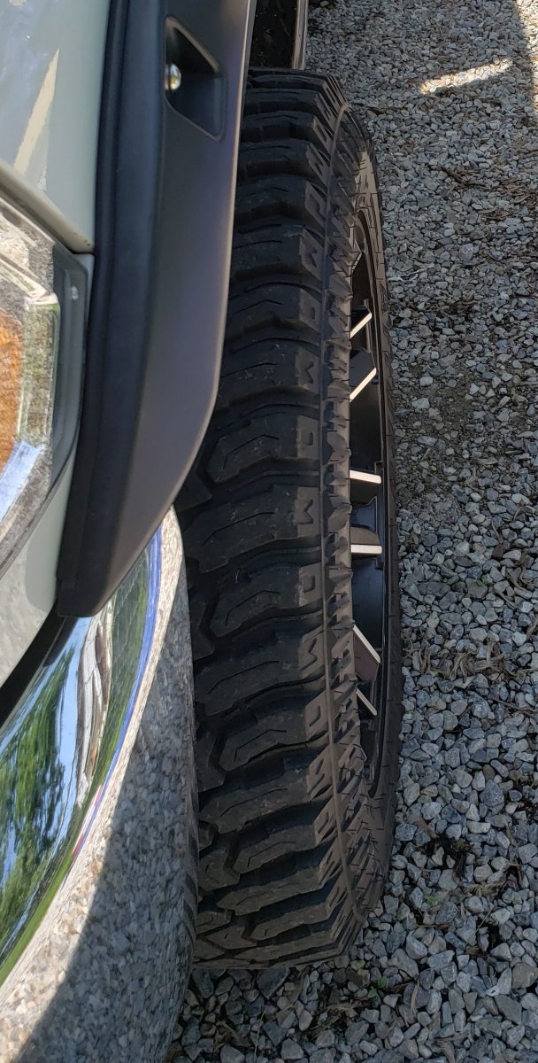

    Heres the look im going after...my neighbors ram
  21. OP
    john e
    john e Active Member
    Maybe not as dramatic as that though. Just an inch or so
