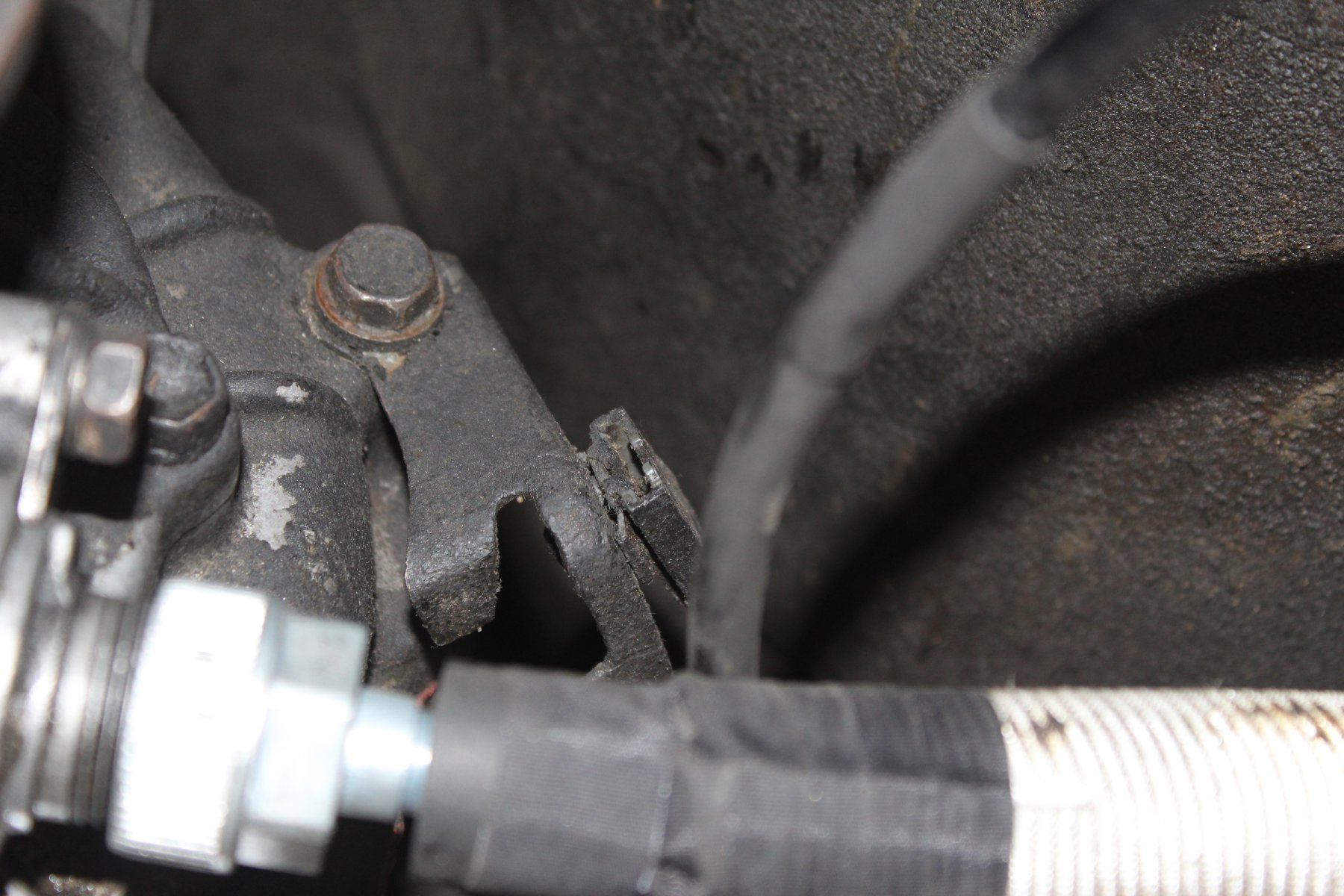

How does a slide pin just disappear or fall out after 32k miles since the YOTA dealer last touched this
The small hairpin clip may have fallen off, allowing the slide pin to work its way out.......

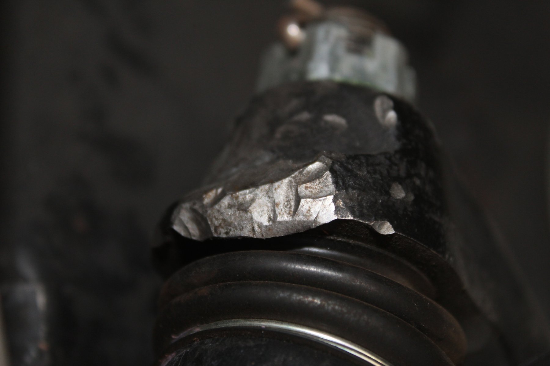

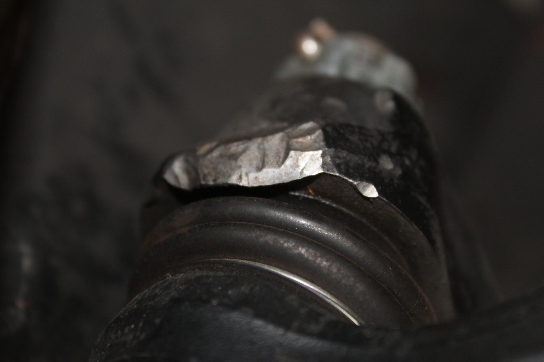

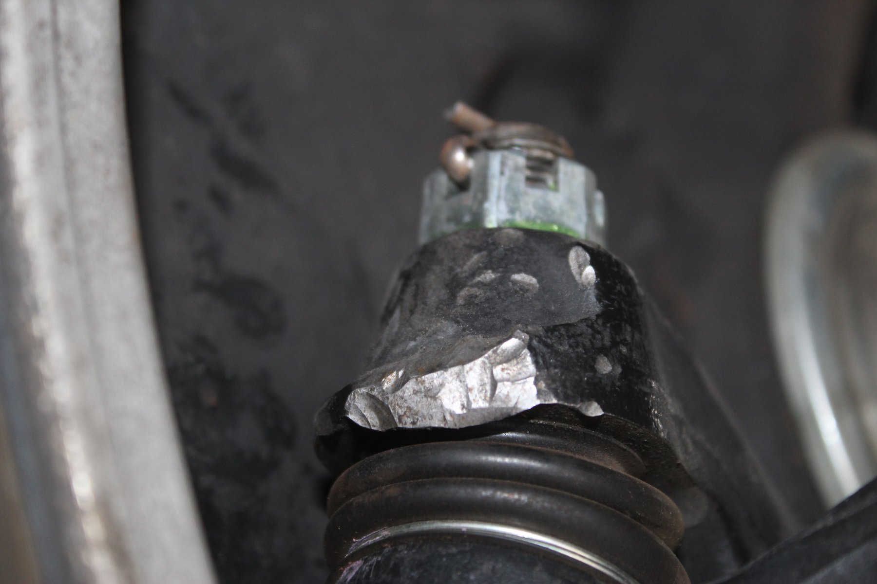

Frankly, I'd be more concerned about the damage on the Upper Control Arm caused by the hammer welding gorilla. Specifically, why doesn't the shop have the proper joint splitting tools? What other parts were "hammered"?
found this LBJ buggered bad
it only had 3 months onit
and cost some good coin to get replaced at the yota dealer (along with the wheel bearing) back in September
there is a cotDamn SST to porperly remove this OTR joint i do believe without damaging the LBJ with a shock such as this
