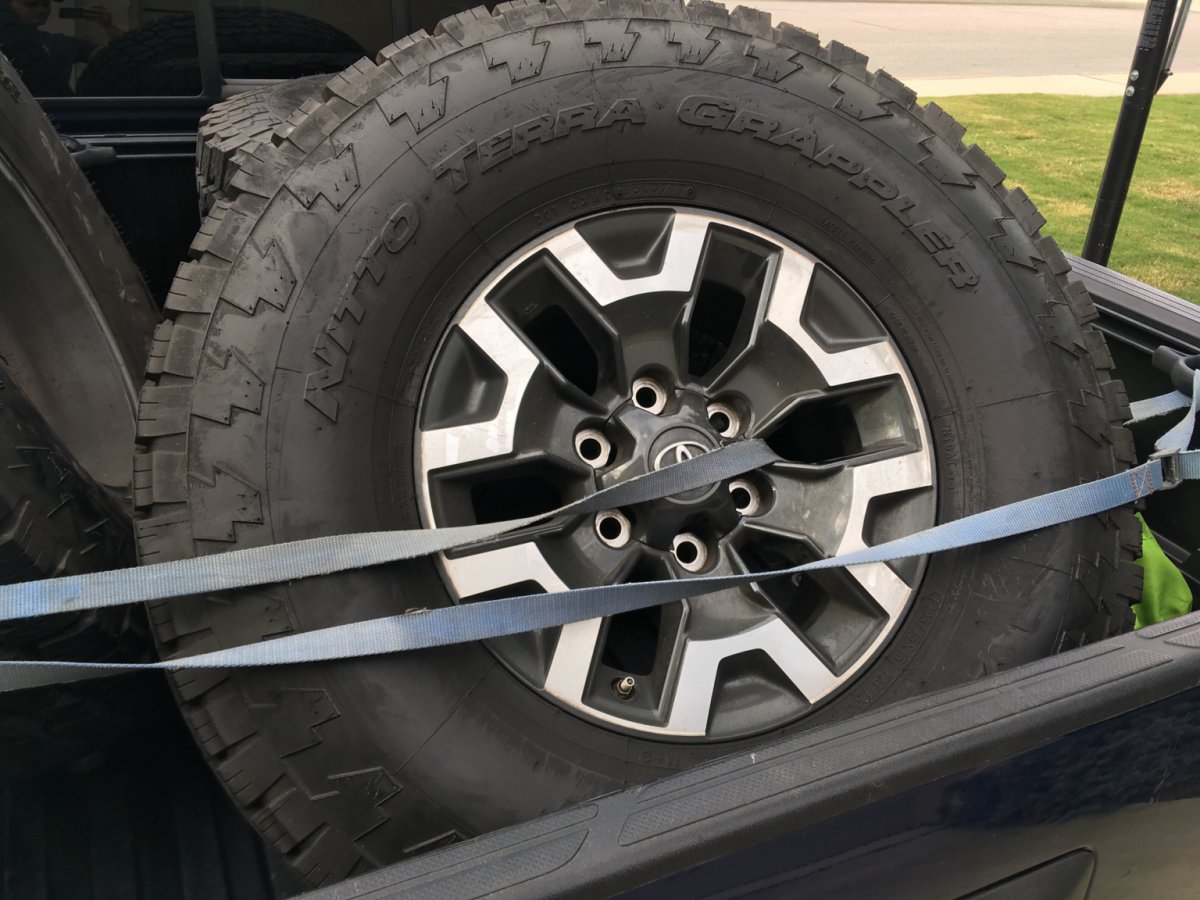

    Ended up getting these- 295/75/16s a guy took off his. I am thinking 3” up front with 1.5” spacers so I can turn with out rubbing. Does that sound about right?
  14. OP
    Eric14TRD
    Eric14TRD Member
    OR17TRD likes this.
  15. OR17TRD
    It will rub but they should fit. A 1.5” spacer would be like -6 offset and 1.25” wheel spacers would be like a 0 offset with those wheels and tire combo both should work. Let us know.

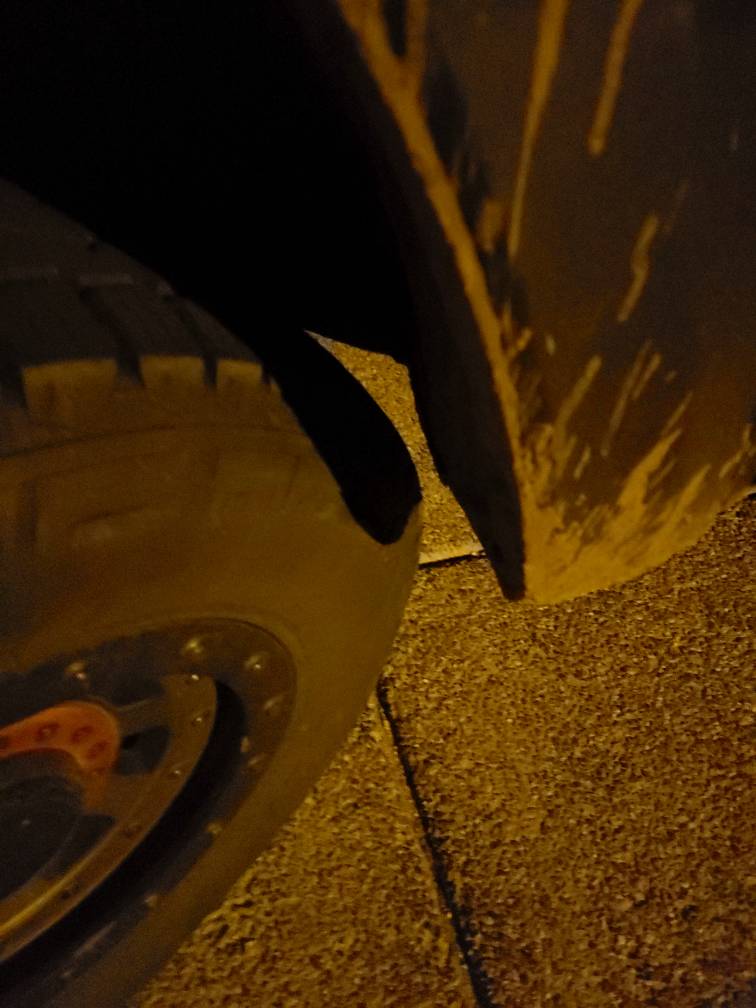

  20. Crawdad
    Crawdad Well-Known Member
    I'm at 2" lift with the same size tire as you picked up. All I've had to do is trim plastic, will do the cab mount chop eventually, maybe over the holidays, I get very minor rubbing though, only turned and tucked. My caster is also at 4
    OR17TRD likes this.
  21. OR17TRD
    Like @Crawdad said you’ll have some molding/trimming to do but 2” would be minimum lift. 2.5-3” is ideal. A good alignment can do wonders. 1.5” total means you’re 0.75” closer to the wheel well and 0.75” more ground clearance.
