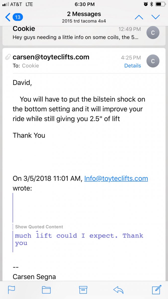

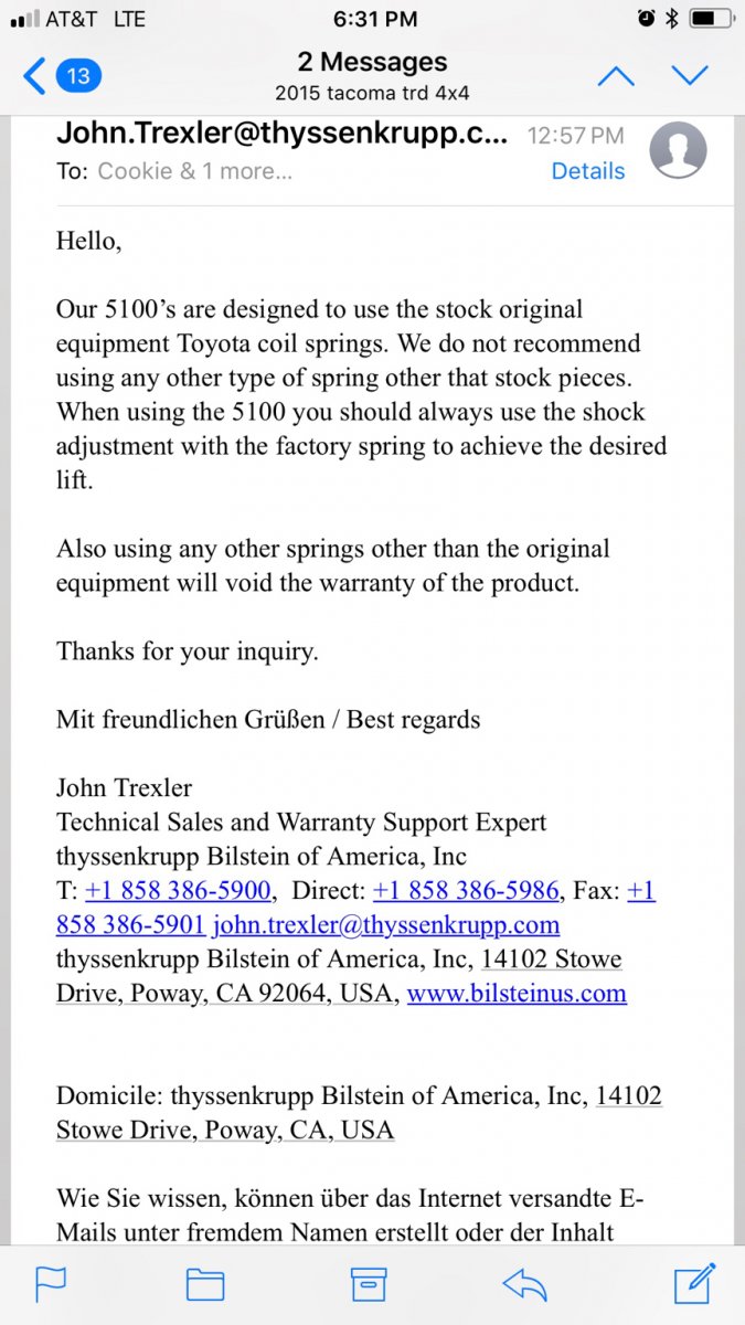

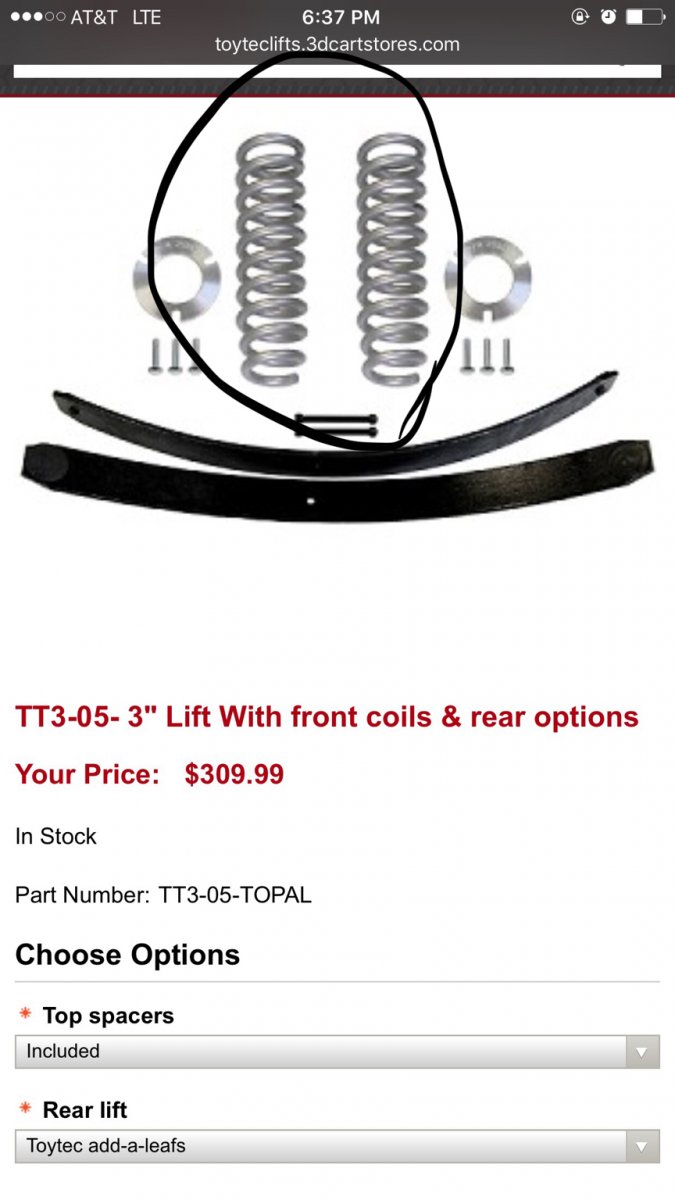

    It looks like you would get 2-2.5” of lift with the bilsteins set to 0. The coils would provide the lift. When you can get lift from coils vs extension of shocks it’s usually going to be a better ride. Depends on the stiffness of the coils.
  9. OP
    cookie47
    cookie47 Well-Known Member
    Here’s what I got from both reps lol honestly at this point I’m thinking save the extra money I was gonna spend on coils and buy something else I want for it lol
