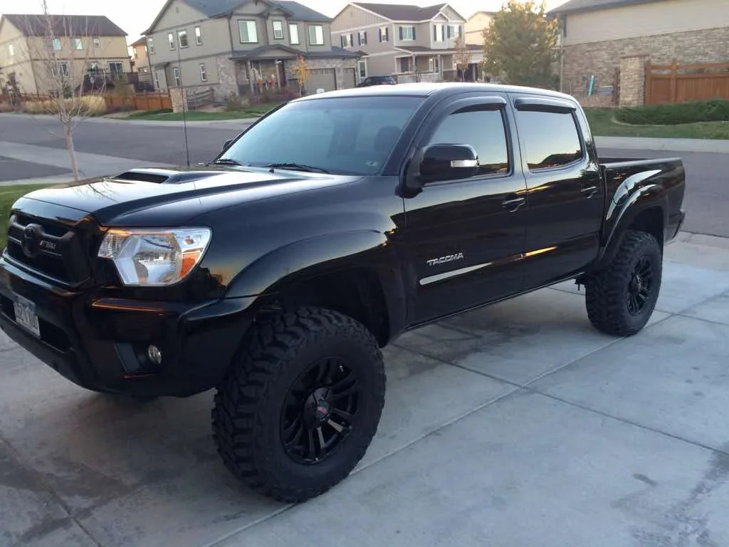

  7. RockyMtnRob
    RockyMtnRob Active Member

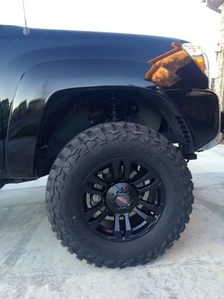

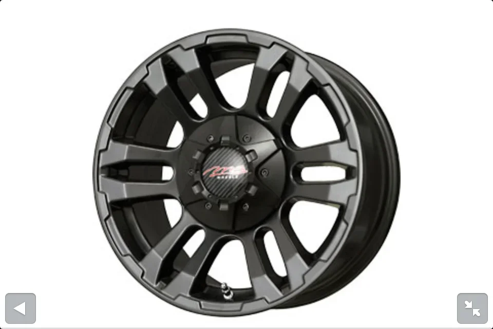

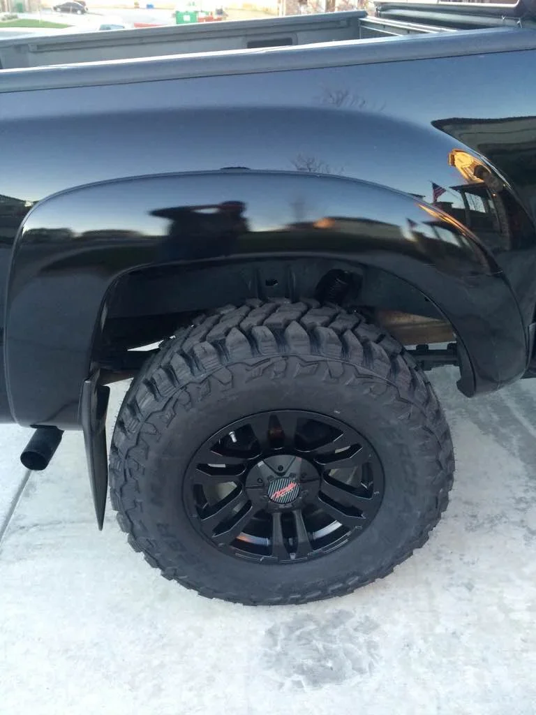

    I used bilstein 5100 front adjustable shocks on the 2.5" lift setting and rear 5100's. I used a 1.5" rear block lift under the leaf spring.
    17" rims x 8.5" width at a 4.5 backspace. Wrapped with Mastercraft MXT 285/70/17's.
    My daughter says the truck looks bad ass.
    Front and rear shocks were about $400, rear block $65, rims and tires $650 & $850. Altogether with alignment was about $2,100. I installed the shocks and rear block myself.
    Minor trimming required on a couple parts up front after removing the front splash guards.
    ImageUploadedByTaco Forum1416162746.040101.jpg ImageUploadedByTaco Forum1416162759.840422.jpg ImageUploadedByTaco Forum1416162774.258518.jpg ImageUploadedByTaco Forum1416162798.626938.jpg ImageUploadedByTaco Forum1416162809.244523.jpg

    Rob, truck looks great!

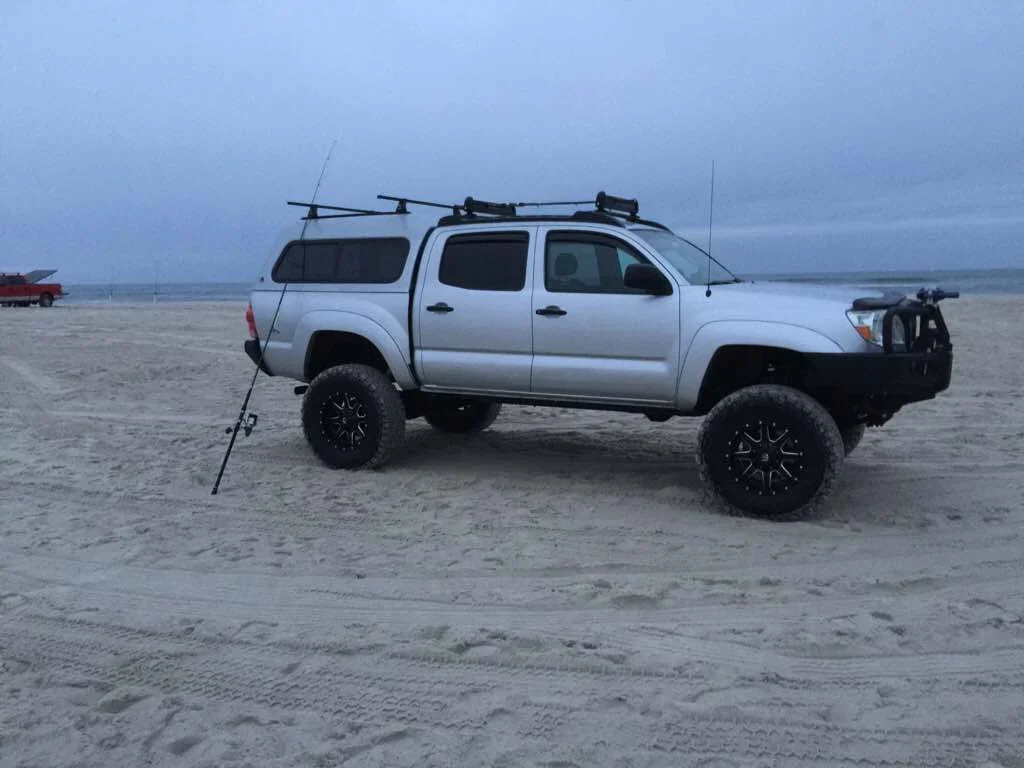

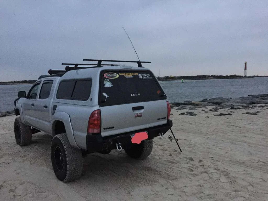

    ImageUploadedByTaco Forum1446962229.233262.jpg ImageUploadedByTaco Forum1446962243.358249.jpg
