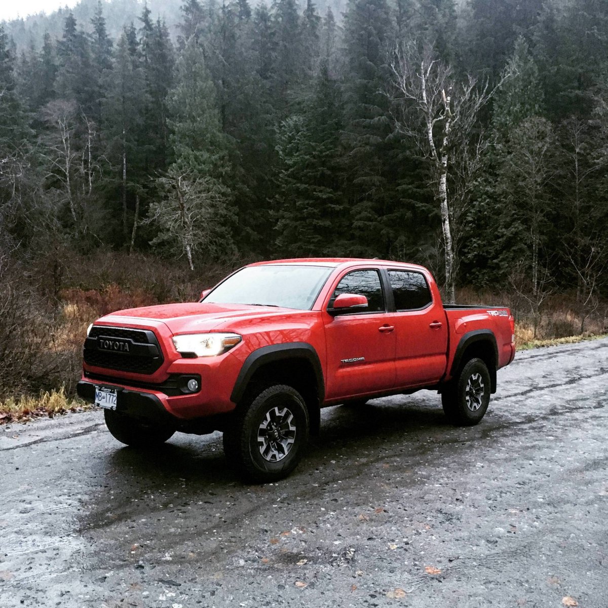

So I got my Revtek 40013 levelling kit, and now want to get rims and tires. I’m hoping to for 16 inch rims and 285/75r16 BFG KO2 tires with 0 offset. Is there anything else I should do while I’m at it? I see some guys doing a diff drop, longer brake lines? Something about a needle bearing?
Thoughts?

If you don’t have the needle bearing issue after the lift you are good for now. It would be an intermittent hum that happens around 35mph you won’t hear it or feel it at lower speeds and it will go away after 45 mph. If you drive at 35 and turn 4wd high on it will also go away.
You won’t need the drop diff that’s something they would have done with the lift.
You don’t need longer brake lines.
You will need to remove the front mud flaps and get a good alignment.
Truck looks great. Can’t wait to see it with the wheels and tires.
