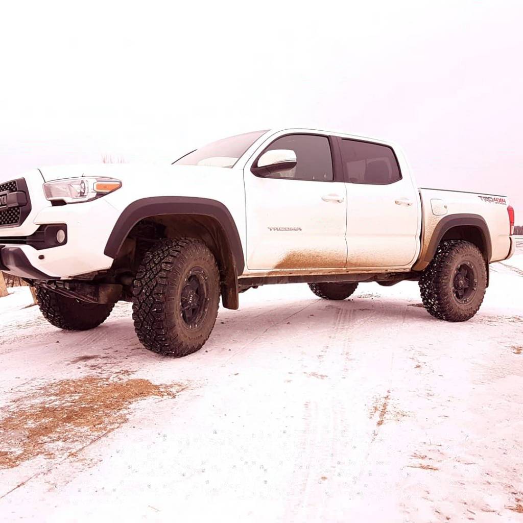

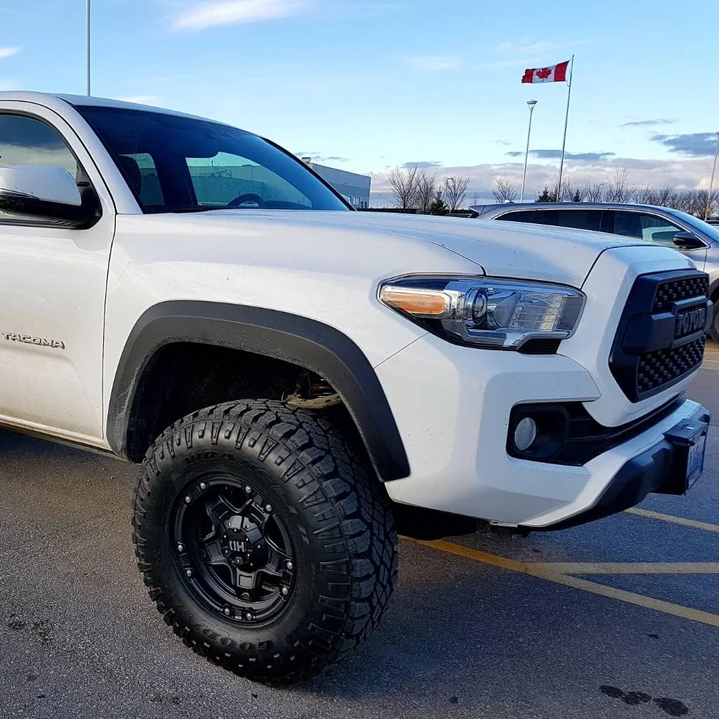

So I got my Revtek 40013 levelling kit, and now want to get rims and tires. I’m hoping to for 16 inch rims and 285/75r16 BFG KO2 tires with 0 offset. Is there anything else I should do while I’m at it? I see some guys doing a diff drop, longer brake lines? Something about a needle bearing?
Thoughts?
Pic for attention
I have the same setup on my 17 dcsb OR - I put 285 75 16's on (Goodyears). I trimmed a bit of the mudflaps and put em back on. No rubbing. I will say that your intention to go with 0 offset may be a problem and you'll get a little more rubbing than me. I bought me wheels with a -13 offset. You may have to revert to a wheel spacer if you're staying with the factory wheels.IMG_20180128_095940_321.jpgIMG_20180111_232744_161.jpg
I have the same setup on my 17 dcsb OR - I put 285 75 16's on (Goodyears). I trimmed a bit of the mudflaps and put em back on. No rubbing. I will say that your intention to go with 0 offset may be a problem and you'll get a little more rubbing than me. I bought me wheels with a -13 offset. You may have to revert to a wheel spacer if you're staying with the factory wheels.View attachment 15070View attachment 15071
