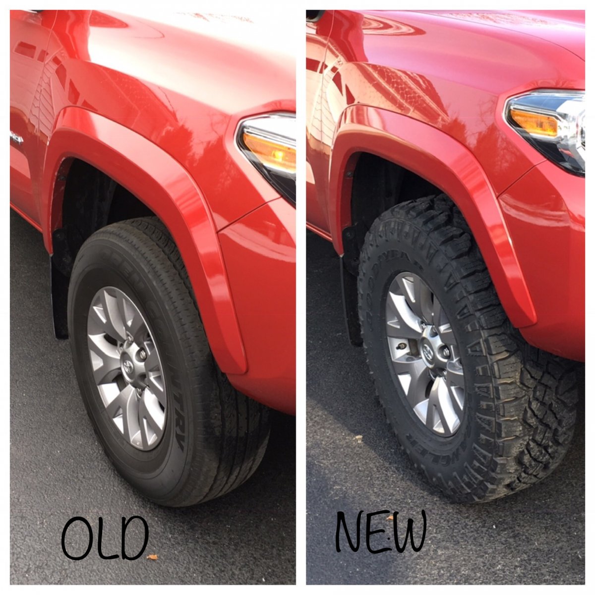

  8. paterran
    paterran Member
    I used Or17TRD's advice last month. Finally upgraded my factory 2016 SR5 tires from 246/75/16 to Goodyear 265/75/16. No lift, no rubbing with mud flaps. Some noise but not bad. Lost 2 mpg city. Worth it! Thanks Or17TRD.
