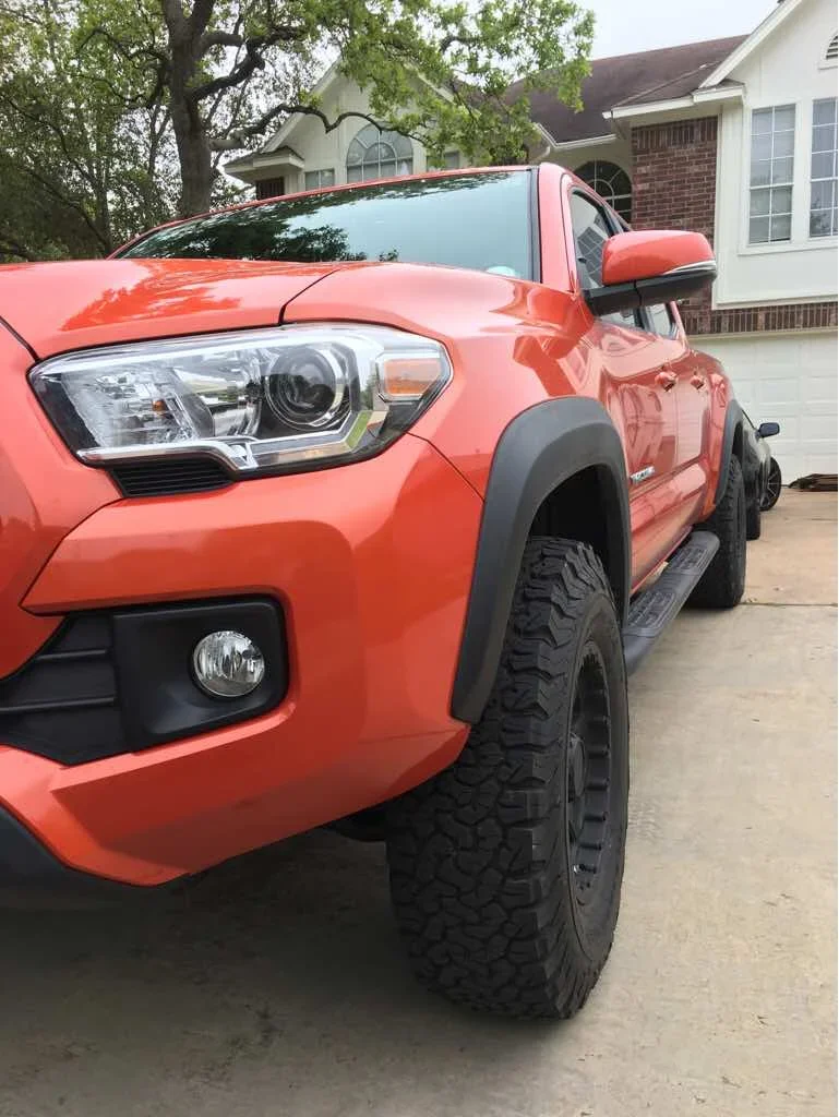

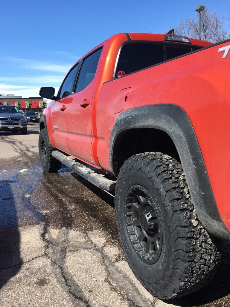

I have Pro Comp 7032 16x8 4.5 backspace/0 offset with BFG T/A KO2 265/75/16. They stick out about 1-1 1/2" more than stock and don't rub at all

16' TRD Off Road DCLB Inferno
Awesome thank you! WEX, exactly the look I'm going for and was planning to get the KO2's as well once I had confirmation of no rubbing. Really appreciate the advice. If you don't mind me asking where did you order from? They carry those on tirerack.com and that's where I was going to order unless anyone knew of a better site or store! Thanks again
Thanks. I actually bought them from discount tire. Just over $900 for the 4 installed with the warranty/lifetime rotation. I would recommend buying new TPMS as the stock ones max out at 55psi.
I run a bit higher on these because they are 80psi max cold. Discount recommended 55psi.

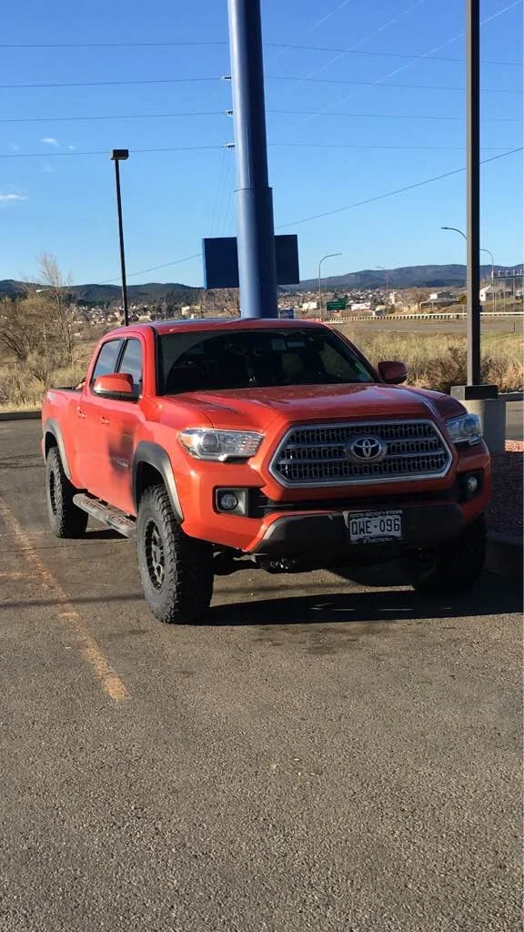

They are the 10ply. Apparently BFG no longer makes anything but 10 in that size, and if that's the look you want, your gonna have to take the ding on mpg

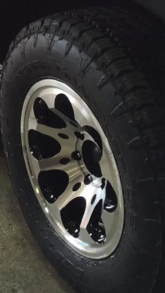

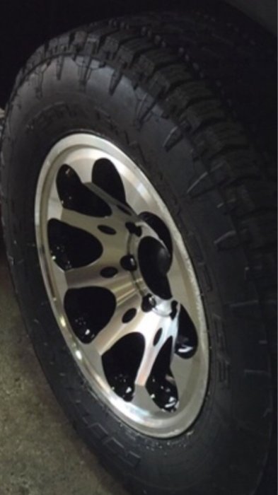

Got these today at Discount tire. 265/70/17s. BFG AT K02s. Got the 6-ply tires. Had a chance to lift both 10 ply and 6 ply. 10 Ply is waaaaay heavier. Discount Tire said 6 ply is fine for my little Tacoma. American Outlaw "Ranger" wheels, 17x8.5, -6 offset.
Had to remove front mud flaps and then trim a little plastic protrusion under the flap, which is not noticeable and would be covered up if flap reinstalled. Don't off road really except for trips on dirt paths with slight bumps and occasional mud at remote shooting ranges.
