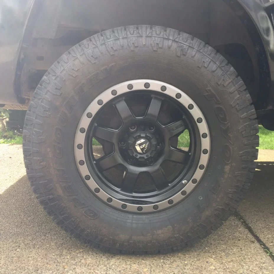

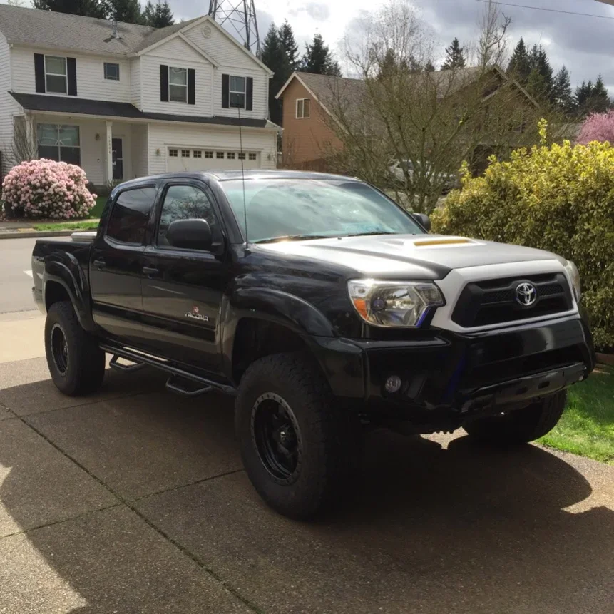

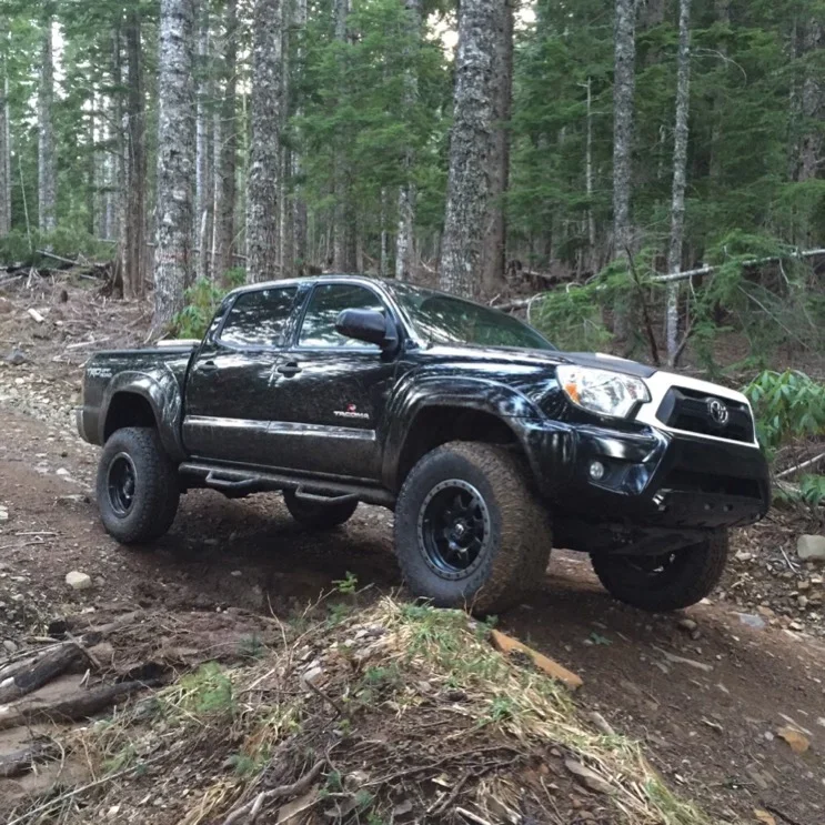

This is my '14 TRD OR DCSB squirrelin' rig
But considering I have a 3" lift with 285s, I'd suggest 265/70 16 17 18... If you intend to get wheels, try to stick with a -6 or 0 offsetImageUploadedByTaco Forum1461785317.414541.jpgImageUploadedByTaco Forum1461785523.911113.jpgImageUploadedByTaco Forum1461785537.678079.jpgImageUploadedByTaco Forum1461785557.997058.jpg
