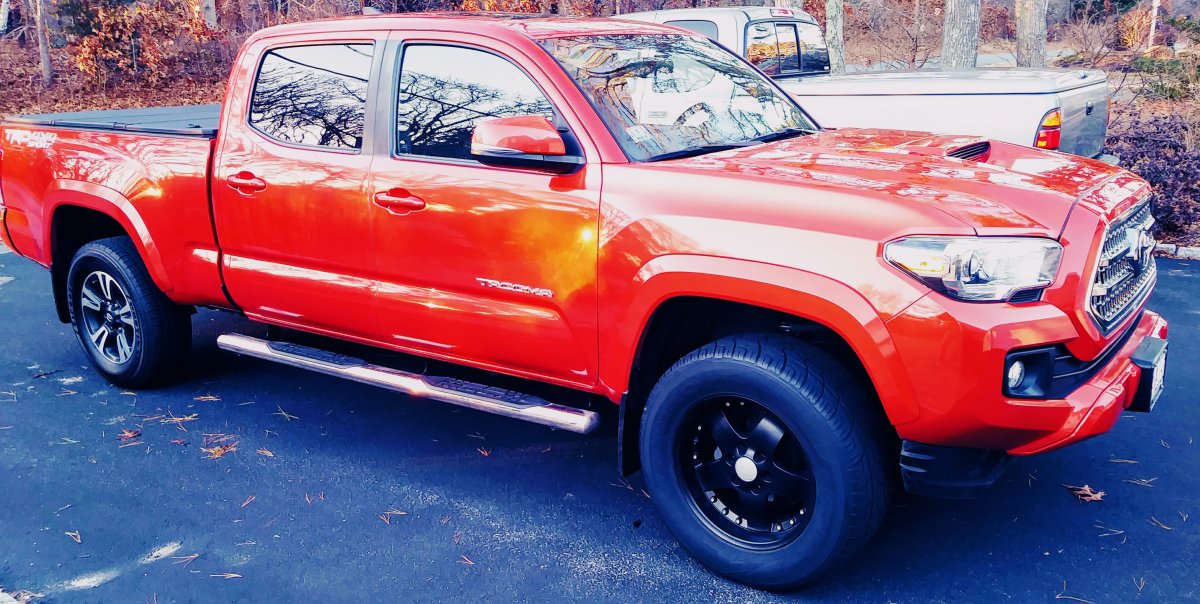

You can put a 285/60/18 on .8.5 inch 0 offset .With 4.5 backspace as well no lift road tested these off my tundra before i sold it .And they did not rub they are like 30.5 tall 20180113_160339_Film1.jpg
You can put a 285/60/18 on .8.5 inch 0 offset .With 4.5 backspace as well no lift road tested these off my tundra before i sold it .And they did not rub they are like 30.5 tall View attachment 15931
they are 31.5x11.2”
With a 2.5-3” lift you can fit up to:
285/55/20 = 32.3x11.2”
285/60/19 = 32.5x11.2”
285/65/18 = 32.6x11.2”
285/70/17 = 32.7x11.2”
285/75/16 = 32.8x11.2”
