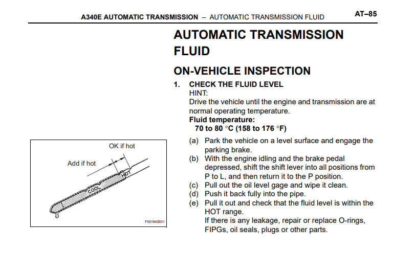

Well I checked the level today when outside temps are quite warmer than a few before and dogoneit it is overfill above the high hash in the hot area... Almost an inch over full :mad:
I assume you are trying to work on the Gen2 A340E automatic transmission coupled to a 4 cylinder....... If so, the following is lifted from the '05-06 Toyota Tacoma OEM Repair Manual.
