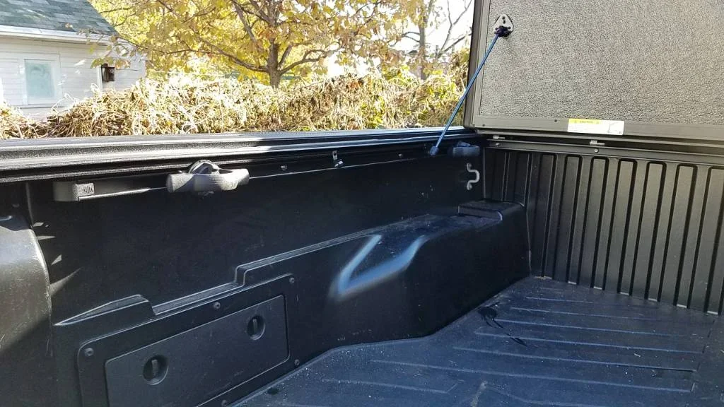

So I bought an Undercover Flex because I wanted something in a hard top that was more secure then a canvas top I had originally. The problem is it's had to find a tonneau cover that's pretty much flush with the top of the bed and still allows you to use the bed rail cleats. Well the Undercover uses the bed rail but I saw a way to mod them to make the rails usable. I order three new rails from Toyota which was about $30 a piece and installed them on top of the undercover side rails and the header went on the end of the cover. Anyways here's a couple of pics 20171106_133330.jpg 20171106_133259.jpg

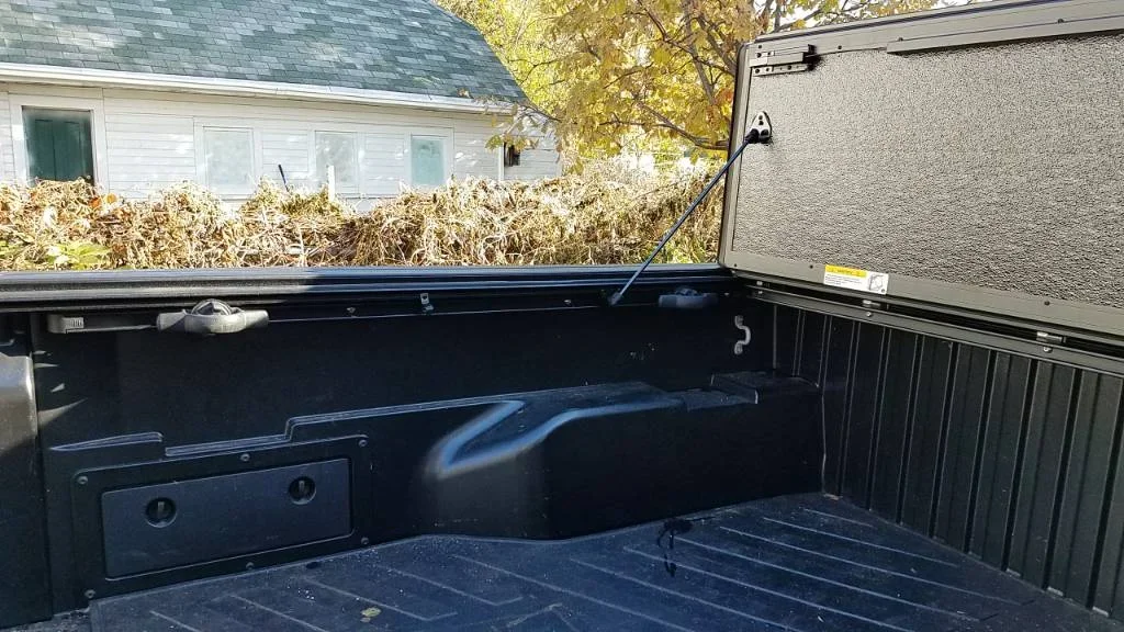

So I bought an Undercover Flex because I wanted something in a hard top that was more secure then a canvas top I had originally. The problem is it's had to find a tonneau cover that's pretty much flush with the top of the bed and still allows you to use the bed rail cleats. Well the Undercover uses the bed rail but I saw a way to mod them to make the rails usable. I order three new rails from Toyota which was about $30 a piece and installed them on top of the undercover side rails and the header went on the end of the cover. Anyways here's a couple of pics View attachment 13594 View attachment 13595

The tonneau cover attaches to the rails so when you have is attached you can't use the rail cleats. So I had the idea of ordering a new set of side rails and a new end rail that goes on the cab end of the bad. I then went to the hardware store and bought to longer bolts and installed them on the inside of the tonneau cover mounts so I could use the cleats when the tonneau top is open.
I believe I had to install 1/4 inch spacers between the tonneau mount and the new rails and also had to cut down the head rail since it was a little to long. I would take more pics but a little to cold right now. But will when it warms up a bit.
