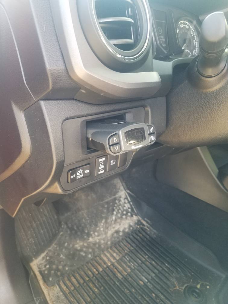

    Im using Tekonsha P3 from etrailer. Came with the harness, which plugs in behind drivers side kick panel. I drilled a hole in the left cubby for the wire and just kinda jammed the controller in. Works great, fits good without any brackets.
    John James and B.C. like this.
  3. OP
    bumpedmyhead
    bumpedmyhead Well-Known Member
