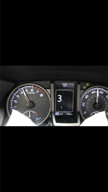

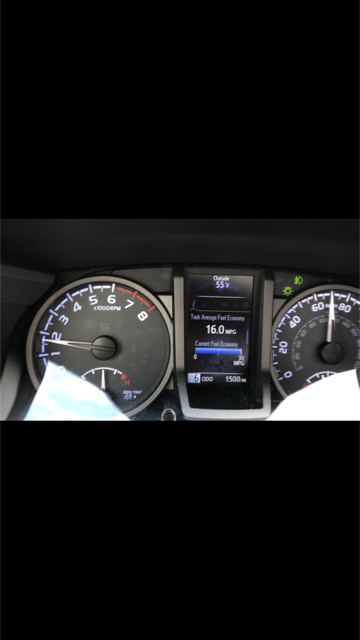

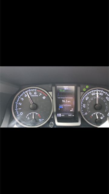

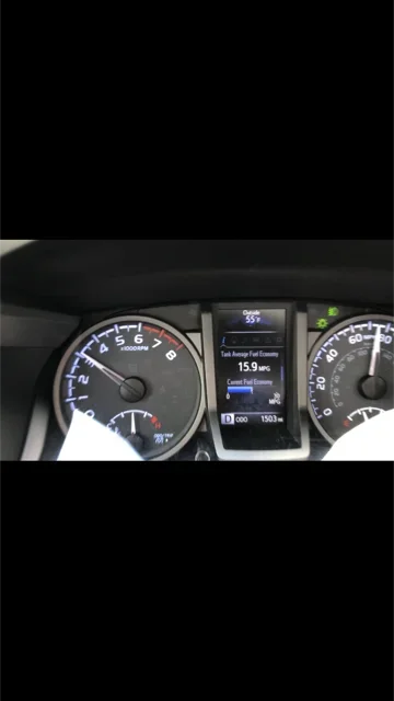

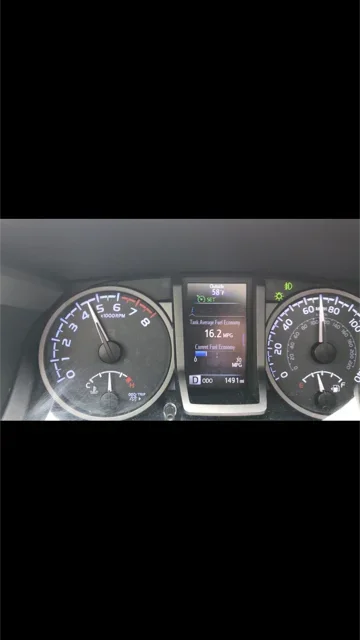

Driving on hwy at 70mph with cruise control set 4500 RPM's had been driving for a few miles like this before I started recording note Odom 1491 miles note MPGimage1.webp after 10 miles of 4500 RPM's I took it out of D with CC and into S mode 3rd gear same RPMs that the truck was at for almost 10 miles before I had enough of 4500rpms at 70mph.image2.webp
I have this all on video, these are screen shots of the video.
4th gear. 2900rpms at 68mph. Note MPG dropping. This is over half a tank of fuel used and the average MPG for that tank.

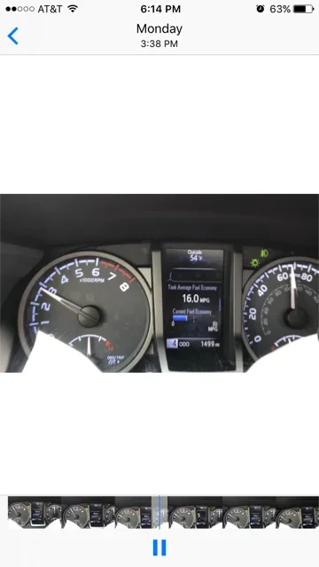

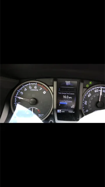

image3.webp 5th gear 2000 RPM's 72mph odom 1500 miles. image4.webp6th gear 70mph 1700rpms drove like this for a mile.image5.webp
Back to D to see where it wants to be at 75mph, it goes back to 4th gear and 3100rpms Odom 1503 milesimage6.webpNote mpg after 12 miles. .3 mpg decrease. I would expect the transmission to down shift when it's suppose to giving me closer to the MPG advertised. I do get better MPG if I use S mode all the time I can get 16-17 in town and 19-20 on hwy but I purchased an automatic thinking it would do its job on its own. I would have bought the manual if I wanted to shift
