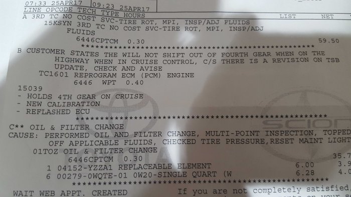

Noticed last week when dealer did rev1 that its also coded as TC1601. So far so good using cruise in D with no 4th gear at 75mph problems. So far being the key words there. 1493570750573.jpeg

Uhoh.... I had Rev1 TSB completed a few weeks ago and seems to have solved the CC in low gear (4th gear at 75mph) issue. If you've had TC1601 REV 1 done, and still have the problem, maybe mine's not as fixed as i thought... If I experience it again, dealer will do a trade in for something else. Maybe a Tundra would be a better option if trade in is necessary..
