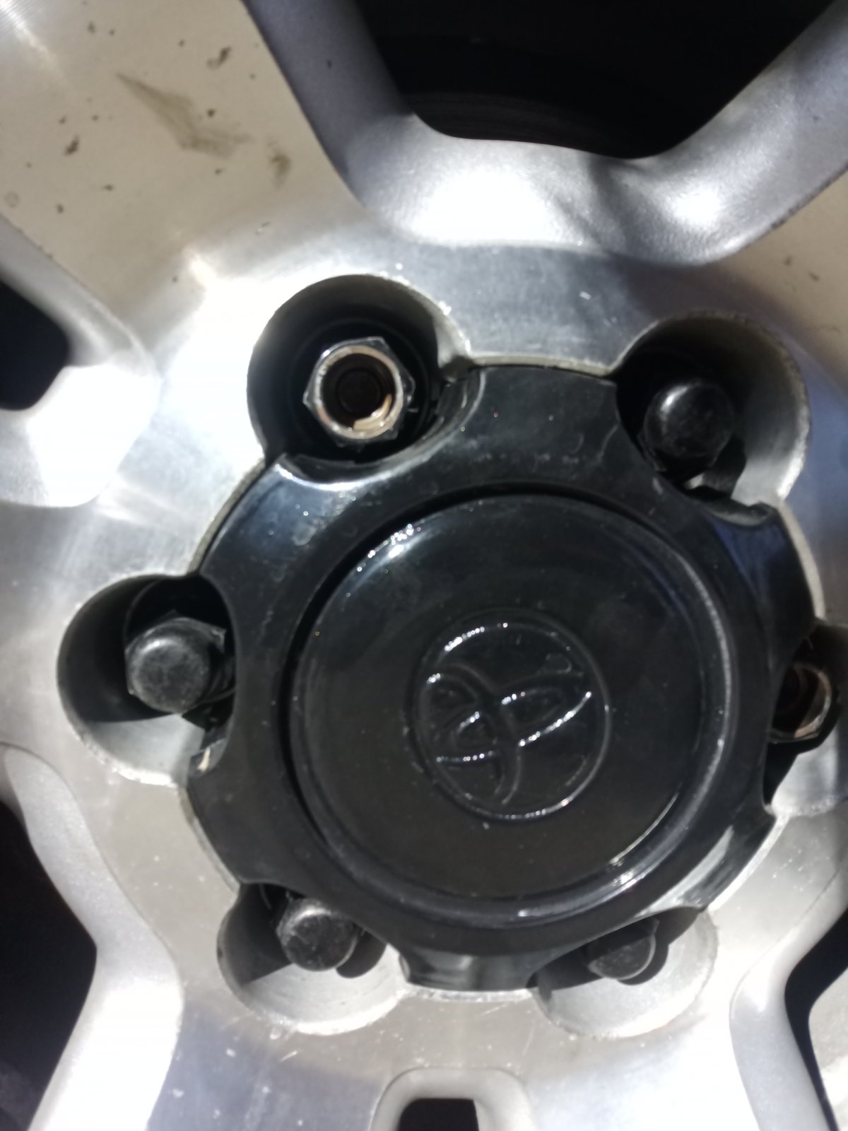

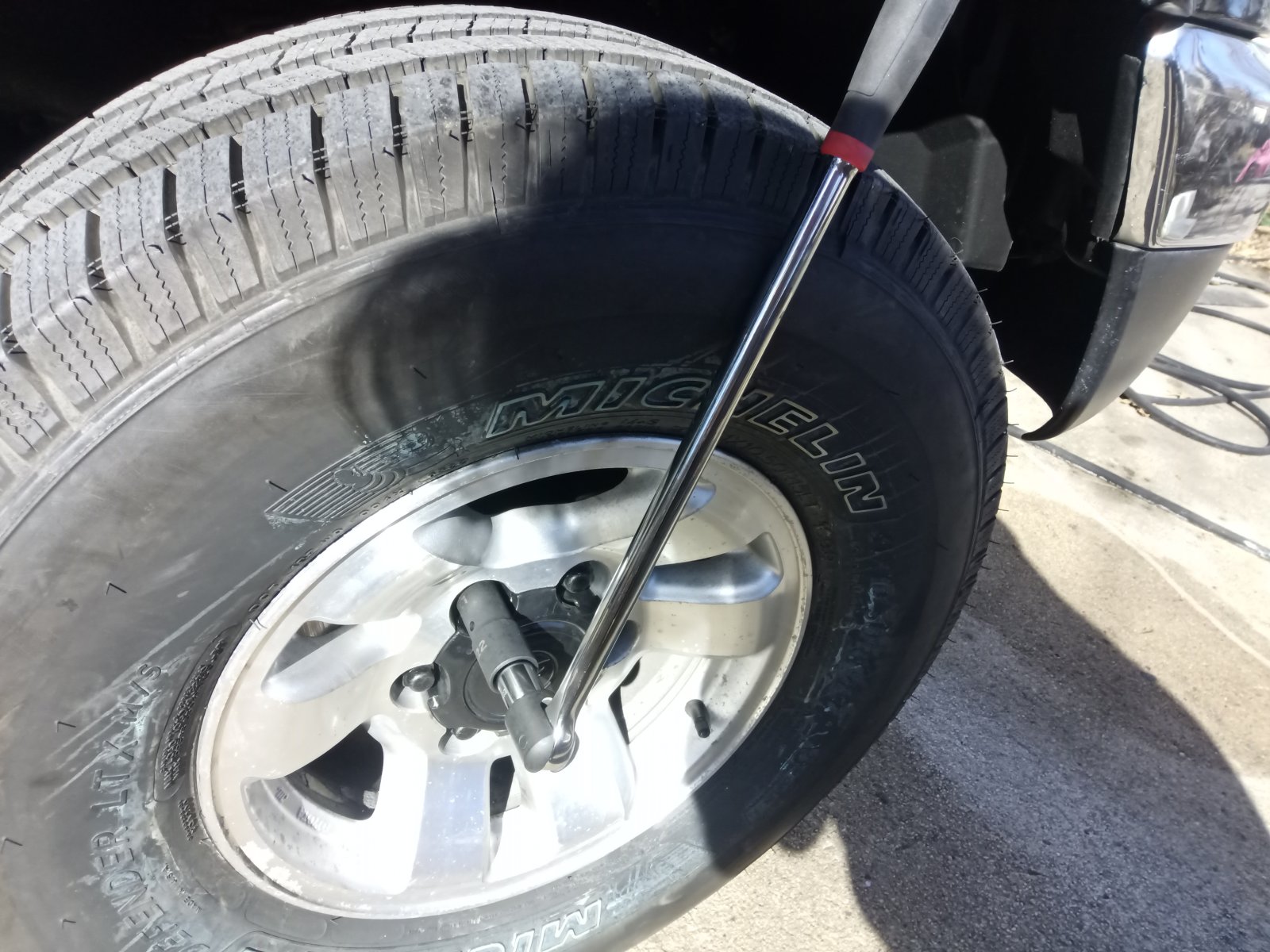

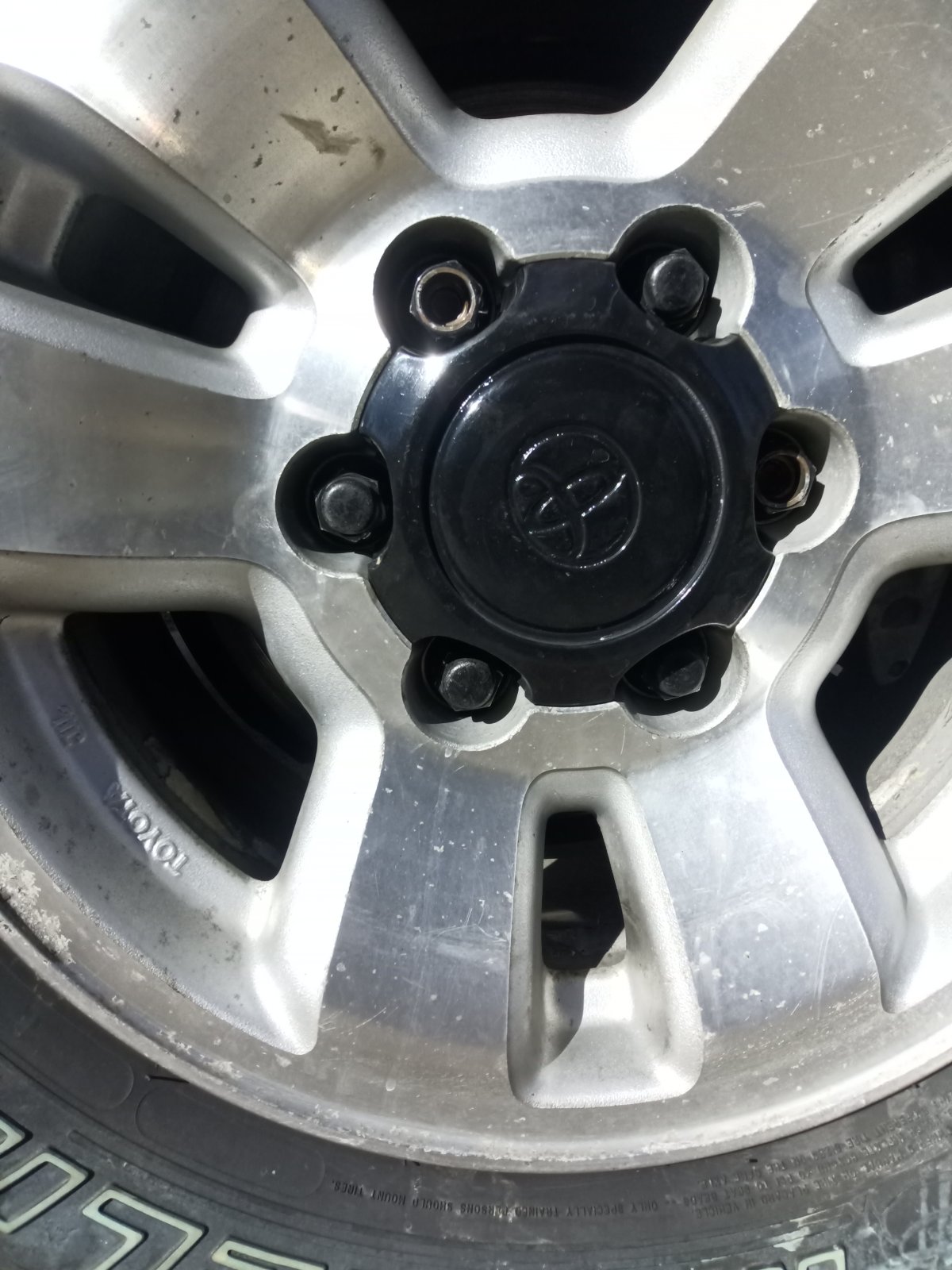

Found 4 broken capped lug nuts that were less than 5 months old
Gotta replace and torque to 83 ft lbs
dorman crapped nuts :(
It was the use of power tools to zip off and zip on
I use breaker bar and easy to remove most of the time
Hand ratchet and torque wrench to install properly

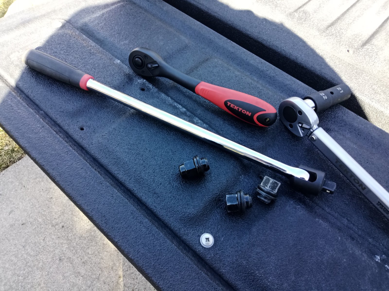

IMG_20240228_145242_460.jpgIMG_20240228_145233_194.jpgIMG_20240228_145522_006.jpgIMG_20240228_145328_918.jpg
Something to consider.
If the top of the lug nut is popping off, then the stud could be too long or the lug nut not deep enough or the wheel flange is too thin.
Looking at those lug nuts, I'd suspect they are too short for the studs.
These are chinese dorman pieces of crap that break with a power drill
OEM lugs cost twice as much
If the lug nuts are too short for the studs, then the tops will pop off. Doesn't matter who made the lug nuts.
Its a steep learning curve on physics thing. Its like running a bolt into a threaded hole that is shorter than the bolt. It'll bottom out giving a false impression of proper torque without correct clamping.
FWIW, those lug nuts are available in different lengths.
Advance auto parts sold me these, also bot some on rockAuto
Guaranteed to fit per their computer lookup
I need to figure out how to measure the depth of the old weathered OEM that they replaced
