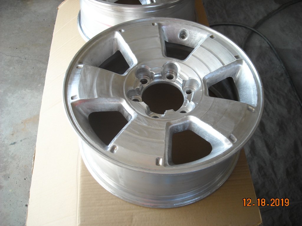

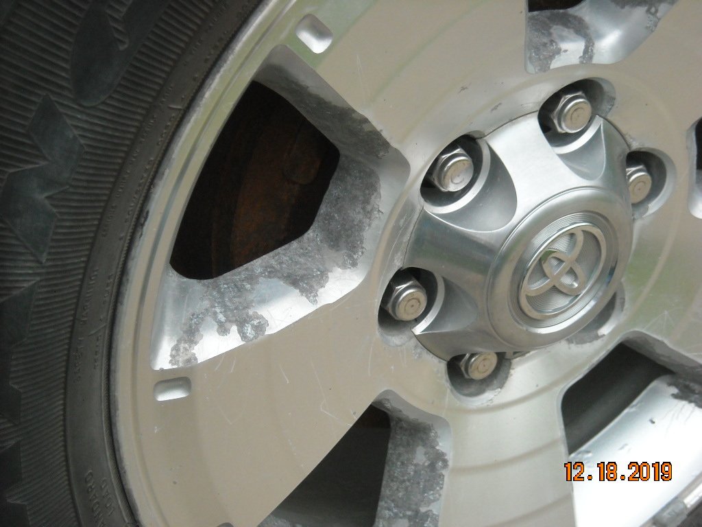

My OEM 17" wheels had peeling and extensive surface corrosion. I did the refurb and paint. Its a lot of work to strip the OEM coating to the aluminum. I tried chemical strippers......didn't phase the coating. Ended up, after several trials, using a series of wire wheels on a small angle grinder. The stripping took roughly 5-6 hours per wheel. Prep for paint was about 1 hour per wheel.
I used Sherwin-Williams automotive paints. All were 2K type paints. Primer, color, clear coat. All the paint cost close to $400. Entering the 3rd winter road schmutz and the wheels show no signs of degradation. I'm pleased with the results and much less expensive than new wheels.
A couple of pics.... Corrosion (1st), Stripped/Prepped (2nd), Final (3rd.) Note: ignore the picture dares, I didn't reset the date in the camera.

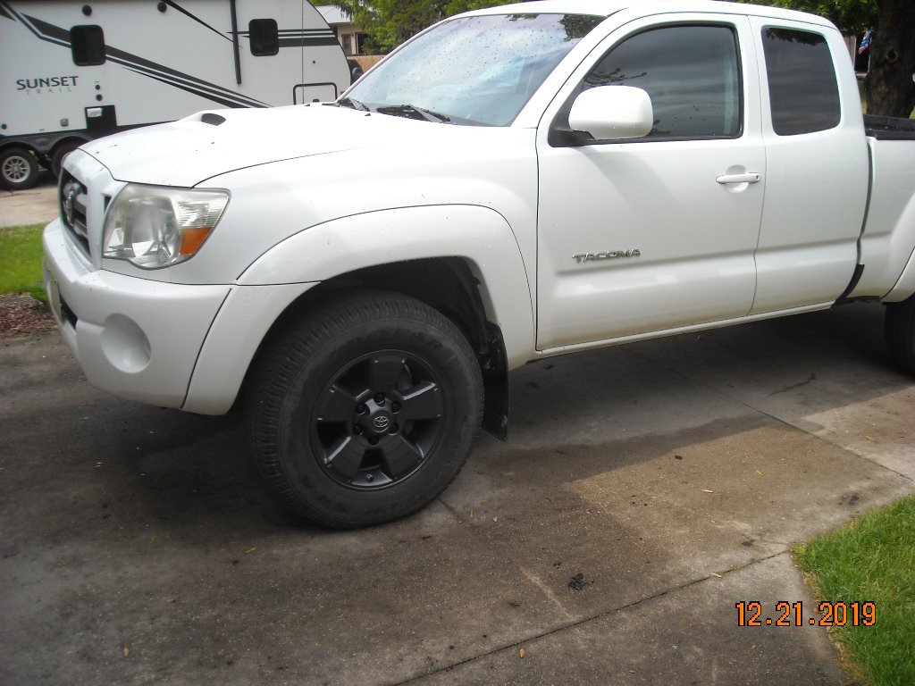

On the truck.....
Color is not black. A dark gunmetal grey with a bit of metal flake with a satin clear coat.
