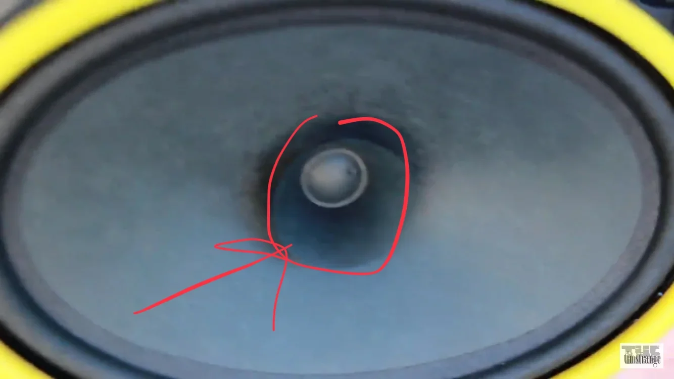

Good deal. Looks pretty darn close to mine. The stock door speakers DO NOT have tweeters. When you remove them you will be shocked at how cheap they are and how good they sounded. As far as the door install they are easy as pie. You can find specific video instructions at oemaudio.com and they provide the tool list required. There is one time consuming step that can be skipped. On top of the required 4 tools also use a bungee cord on the door panel. If you do not have any then pick up a bag of them at the dollartree store with plastic hooks. Instead of disconnecting the door handle cables simply hang the door panels in place so, they are just floating in place. and you can work around them. I did that and balled up and placed a small hand towel between the door and the panel to give me space to work. Mine is an access cab so I did completely remove the rear door panels which did not require any handle cable removal. I just had to remove the lower rear seat belt bolt. This project took me less than an hour to complete for all 4 speakers. I suggest start with the passenger front door. That gives you more space to work and will make the other doors go quicker. I have done dozens of audio installs and upgrades and this was one of the easiest. Another suggestion is to remove the original speaker assembly and sit it down on a bench. Assemble the new speaker and mount next to it so you can compare them. This will insure the speakers are not mounted upside down in the mounts. Wire connections on speakers need to be mounted so they are on top and the correct mounts should have an opening on top as well. If this is your first time doing this type of job then you should be done easily within 2 hours. Just watch the video, have your tools together and take your time. Once done you will be one happy camper. NOTE: If it is windy outside quickly put the stock cheap lightweight speakers in a box so they don't get blown across the yard. Yes they are that light. ENJOY.

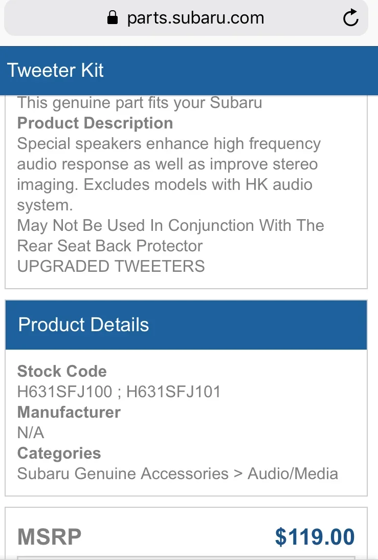

Found the Subaru tweeters part number H631SFJ100 on amazon for $65 and ordered from Crutchfield for the 6x9” and 6 3/4” for $109 all free shipping, free wire harness and mounting kit. I will have everything by next weekend. $174 for speaker upgrade. I’m excited to install and hear them.
How did you get your tweets for only $65? That’s a steal
This is the stock front door speaker that cone in the middle is a tweeter. I knew I could hear it and it was taking away from the clean sound of the H631SFJ100 kicker tweeters I installed. Can’t wait for these to be out of the door. 4D5DA54B-5668-403A-A9D5-322336551089.webp

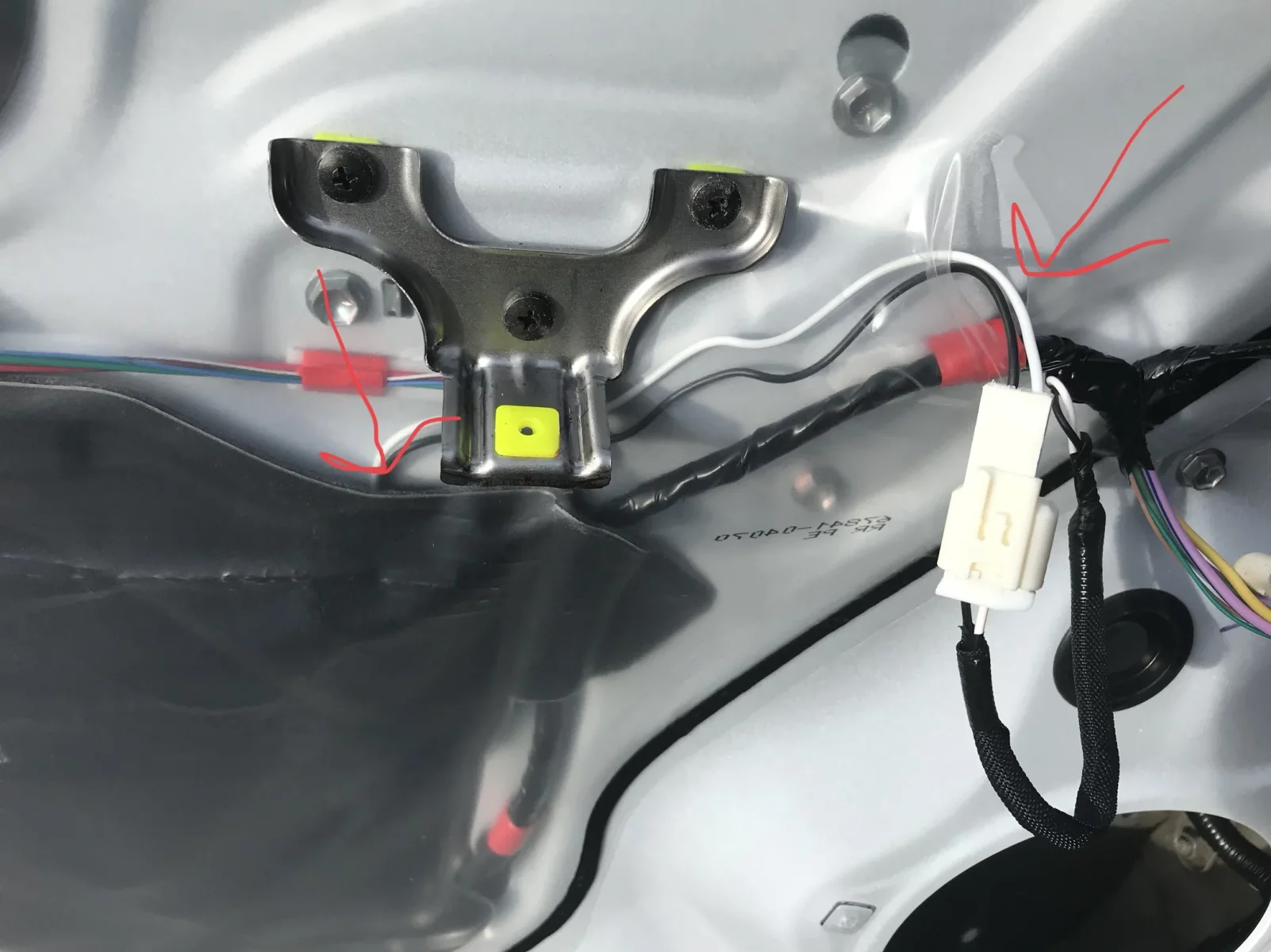

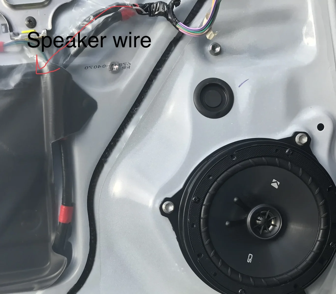

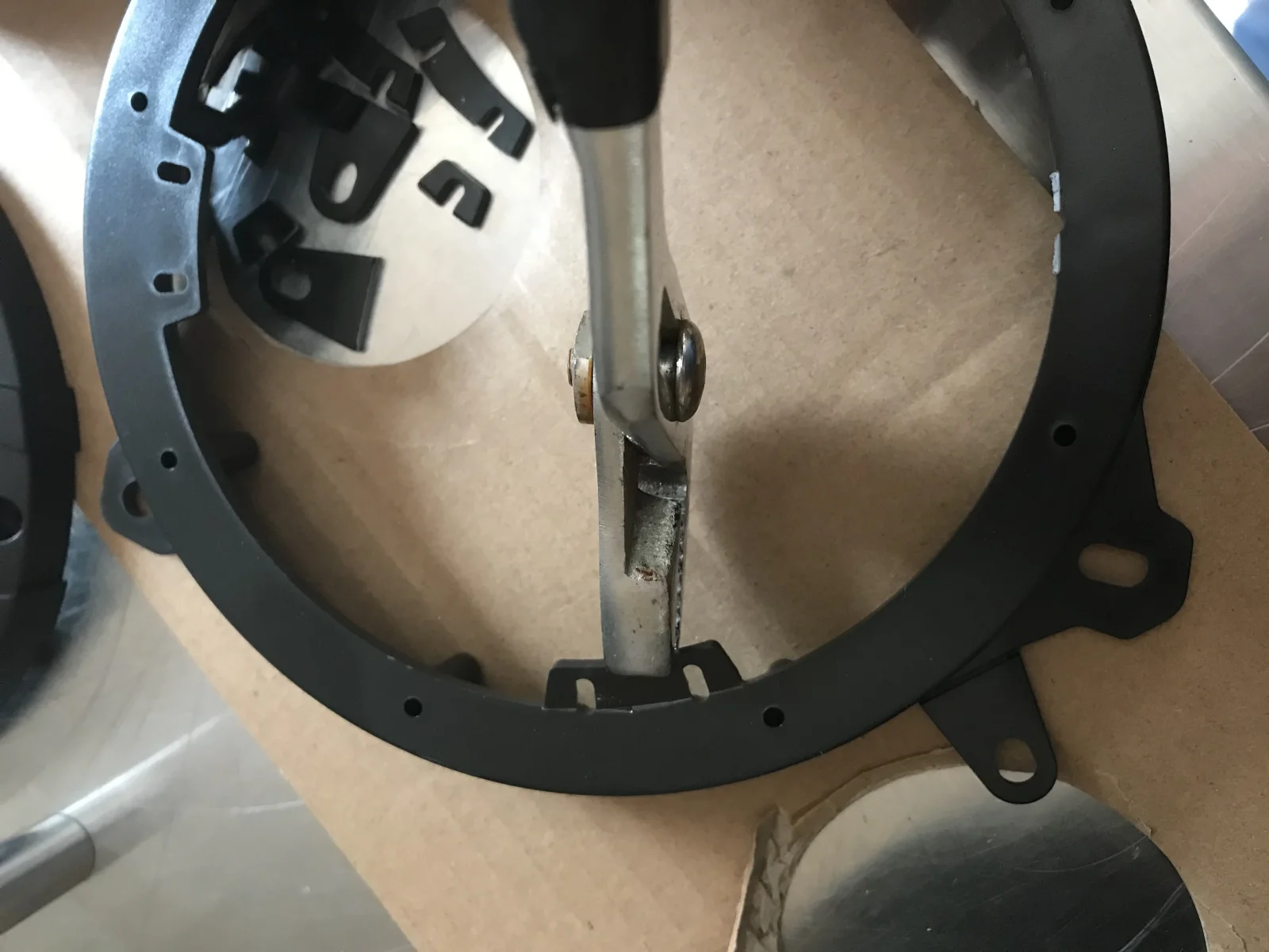

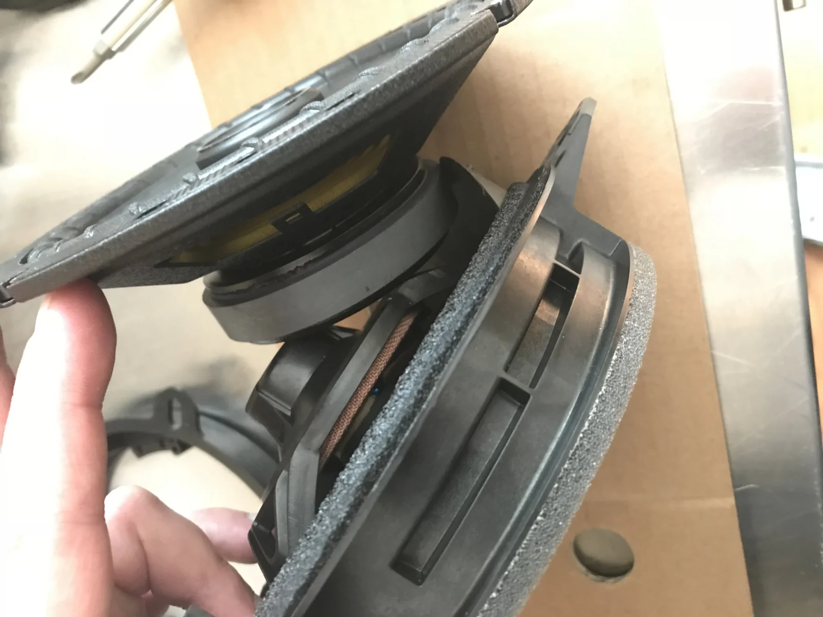

Got the door speakers installed. If you go with the 6 3/4” kickers in the rear there is a little modifications required to mount.
Rear what magnate vs kickers CSC67 magnate. EA6B1C82-8E1F-43F4-B46E-40E87643C8D0.webpPopping the inner mounting points off the brackets so the 6 3/4” kicker fits...2AFEFFF8-1C66-4E99-9D05-12FCD6C29933.webp...Feed the speaker wire adaptor and speaker wire through the opening in the plastic and under the foam...974B65D0-1B59-4905-A819-93B1E3C9C009.webp...Pull the speaker wire all the way through zip tie as needed to keep wires out of window track and connect the rear kicker speaker. Mounting bolts used a 10mm socket...18EA2BD6-0D3C-4941-8153-ACCCD41ECF97.webp...Hope this saves someone some time if they go with the 6 3/4 vs the 6.5” rear door speaker.
Rear what magnate vs kickers CSC67 magnate. View attachment 13846Popping the inner mounting points off the brackets so the 6 3/4” kicker fits...View attachment 13847...Feed the speaker wire adaptor and speaker wire through the opening in the plastic and under the foam...View attachment 13848...Pull the speaker wire all the way through zip tie as needed to keep wires out of window track and connect the rear kicker speaker. Mounting bolts used a 10mm socket...View attachment 13850...Hope this saves someone some time if they go with the 6 3/4 vs the 6.5” rear door speaker.
