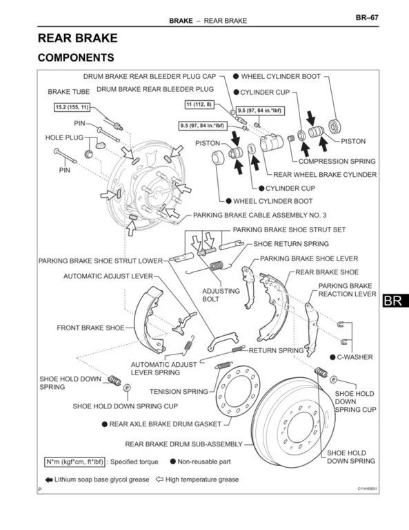

brake drum gasket?
It recently turned 20k miles when I last rotated the tires. Anyone with an oz of commonsense isn't going to pull the drums when there's nothing wrong with the brakes, especially the rear ones.
find your rig's parts diagram to see if a drum gasket is located then?
gotta set up a time to investigate this on the Gen2 where truck is down for extended period

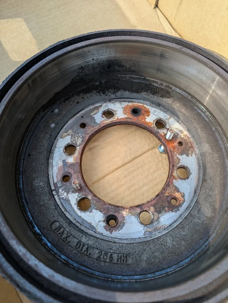

Checking for rear axle seal leak...
removed drum from relatives 2o11 taco, probably first time in ever since the drums were seized and I tried EVERYTHING tic tic
Used those pry bolts and the mallet and the sledge since these aren't coated but are crusting a bit
Remnants of that paper gasket were found but most of it was worn off in 11 years and 66k miles
almost 2 years and 32k miles
what is it going to look like behind there after this time elapsed
