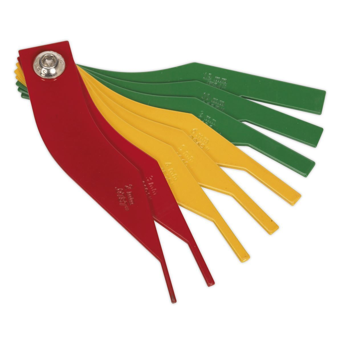

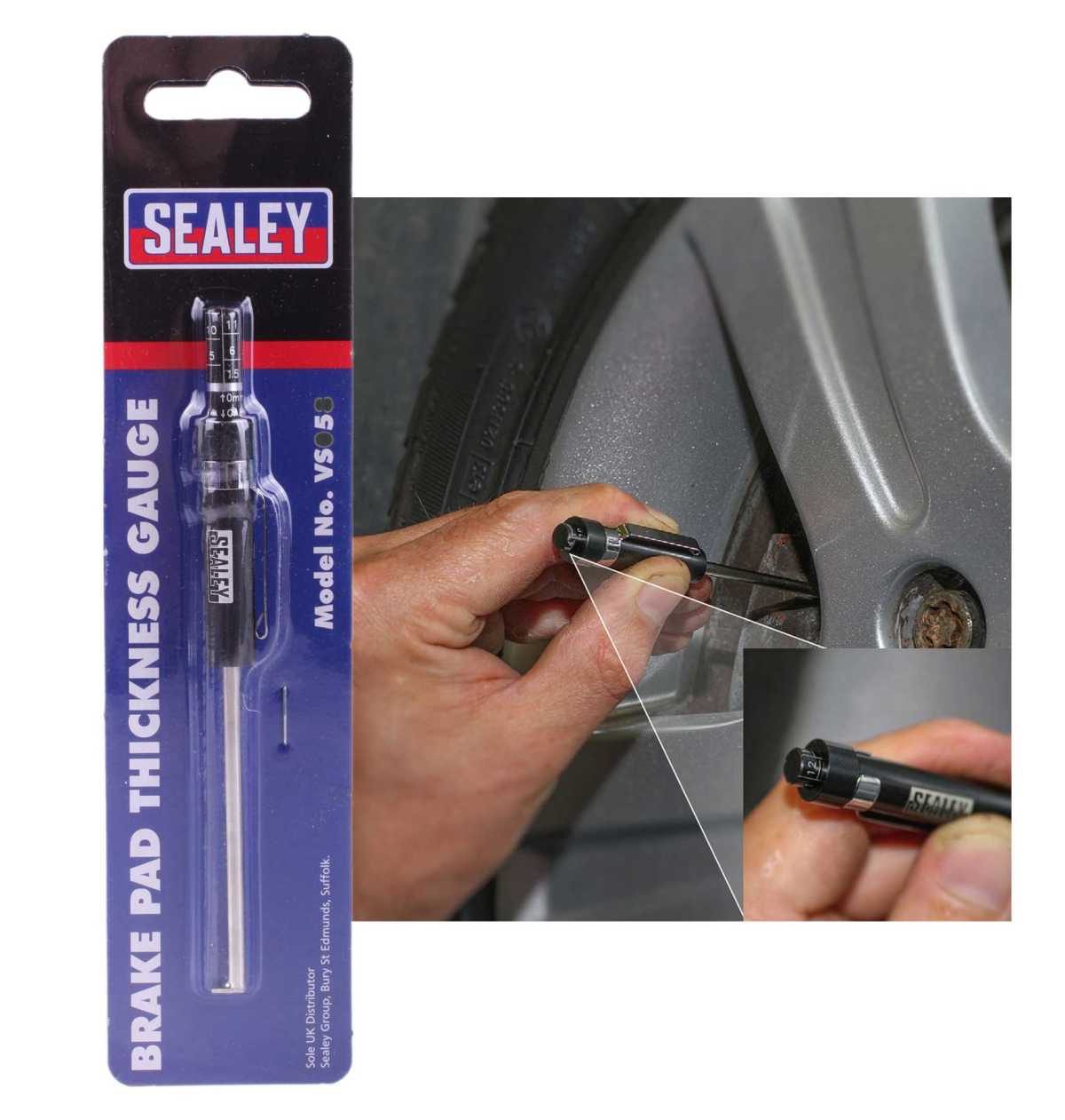

do the brake technicians use some sort of dial indicator to measure the remaining mm of pad usage?
Most have a brake pad gauge to measure the pad thickness remaining.
Pads are relativity cheap. When you rotate your tires it's easy enough to see what kind of pad life you have left. Usually when they look less than an 1/16'' I just replace them.

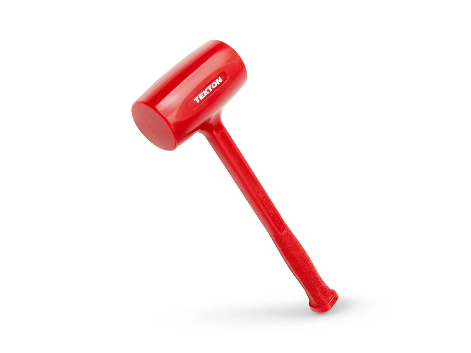

Idk, I'm not the tekton salesman. I just haul out my biggest baddest hammer from my tool cabinet....it's gotta be at least a 4 lb one, and beat the living daylights out of those rotors after they been pb blasted well through the lug/stud holes.
