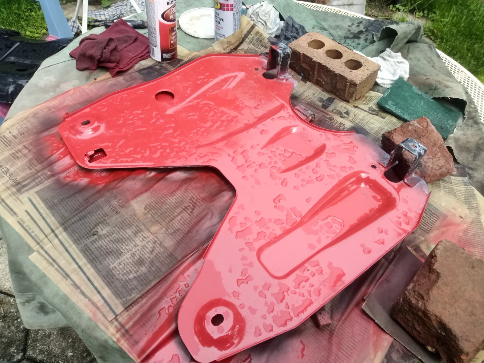

Gen2 suspension crossmember under cover...
might give that middle plate a topcoat of sunrise red rustoleum
to match a red truck on the underbelly where the sun do not shine upon

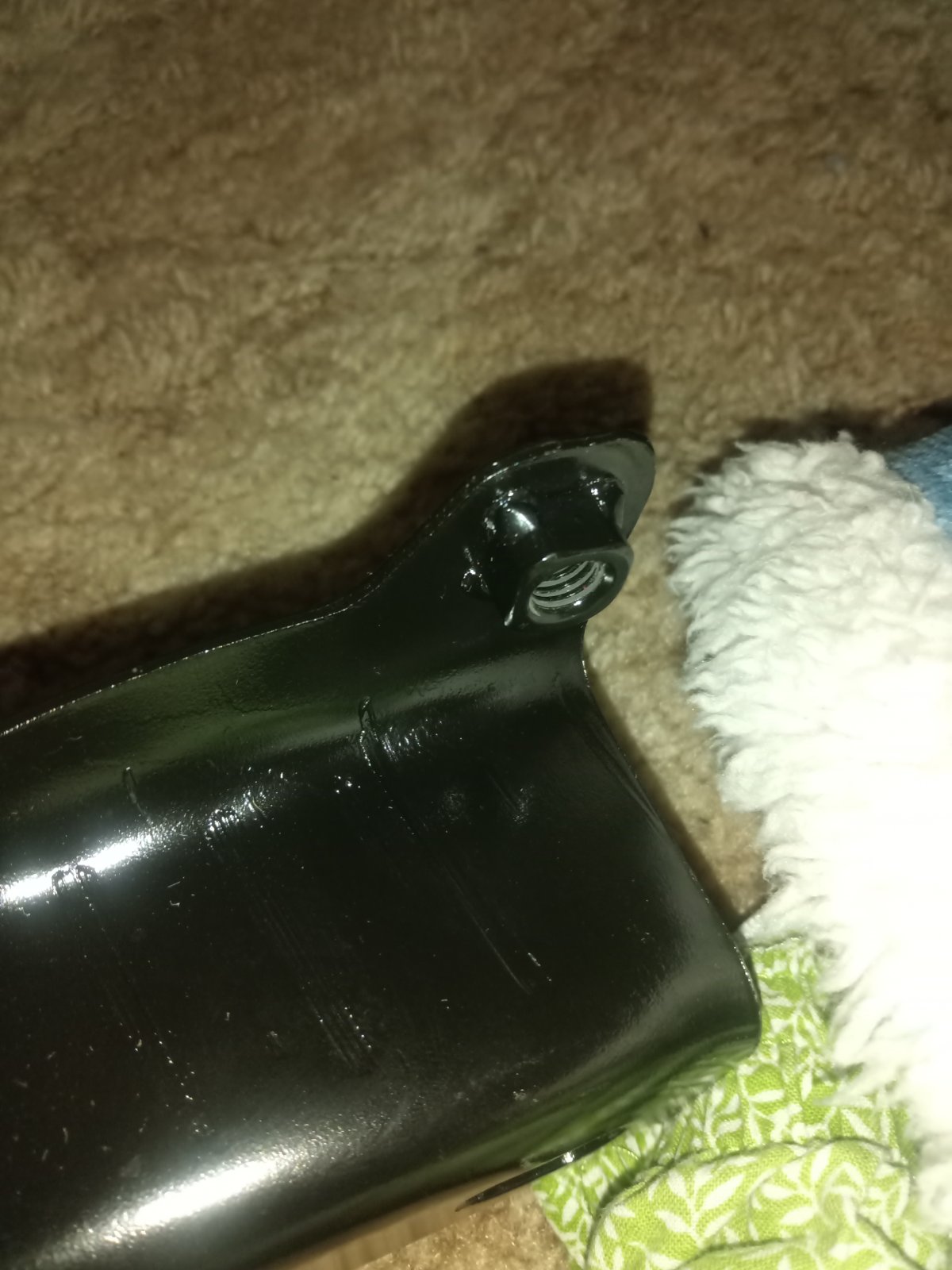

this may be a cause of dissimilar metal rott but IDK
its a subassembly of the frame so the part looks to be replaceable with a new piece and new nut welded onto it
the nut rotted off with the bolt but the frame piece its welded to has NOT a lick of rust that i can tell onit

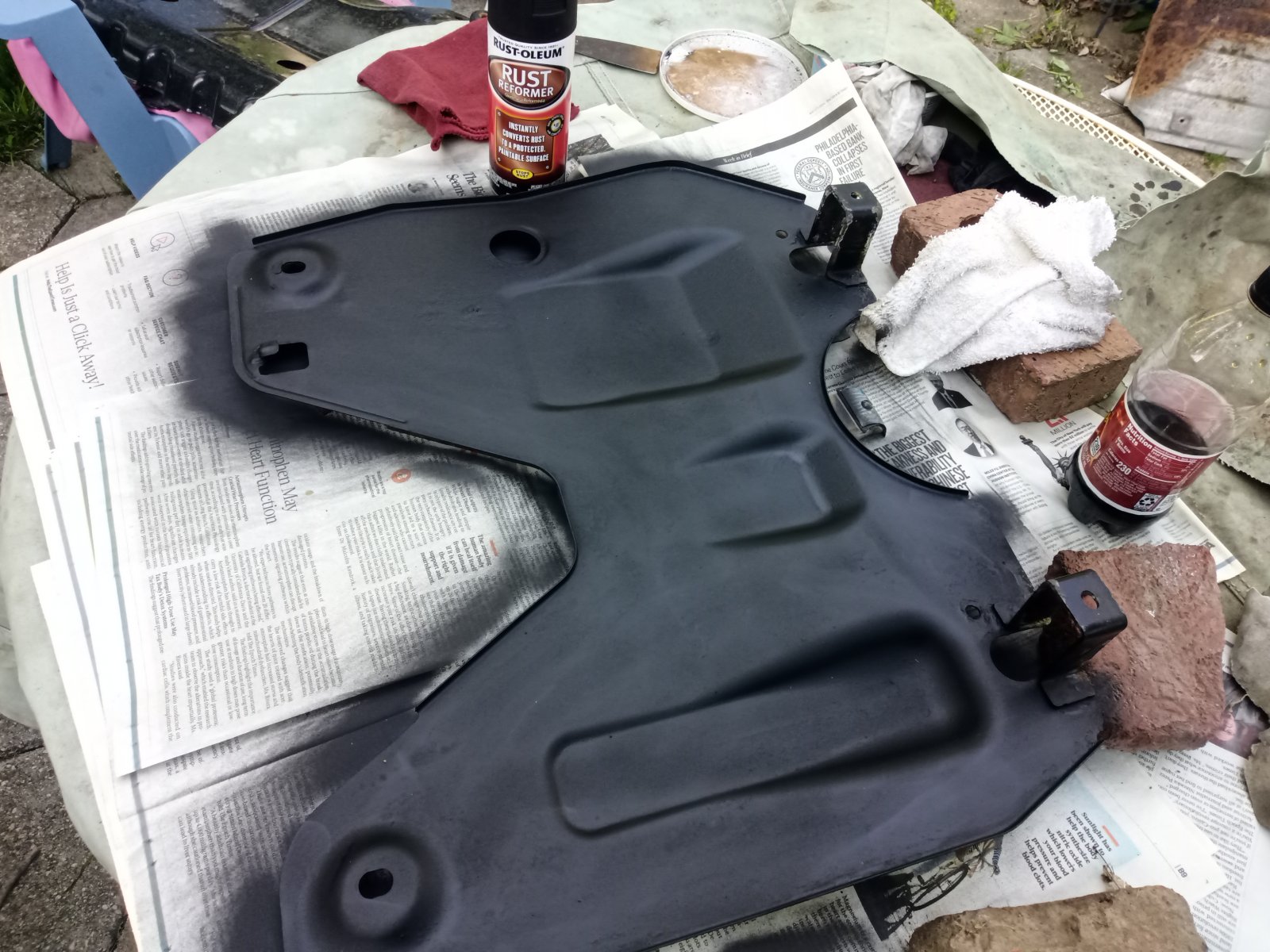

Black looks better, if anything the color aluminum would look nicer than that. I coated my trucks engine shield on both sides with cosmoline 4 years ago...still has no rust, and looks new.
this rusty crusty undercover shield was able to be removed
bolts were not seized and nuts broken?

this rusty crusty shield was able to be removed
Undercover splash shield removal viewed at 2:22
If worried about the 4 shields fastener bolts getting rusty, coat the threads with waterproof grease, or never seize before installing them back.
