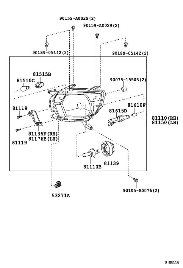

Replacing headlight assemblies on Gen2 is a major task. You will need to remove grill, lower trim pieces and bumper fascia. None of the work is difficult, it just takes time, patience and a few extra body push pins.
Remember, if you replace the assemblies they will need to be aimed. I took mine to Toyota to be aimed after I replaced the assemblies. Cost was just under $100. BTW, I purchased OEM at $170/ea.
The reason behind purchasing OEM headlight assemblies is because my research on the aftermarket stuff was not encouraging. Reports indicate that the aftermarket stuff degrades in less time and may have wonky reflectors.
