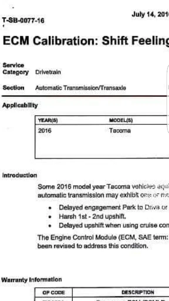

Tsb-0077-16 here is answer to everyone doubting it is software issue on transmission on the new 16s. Everyone doubted me look it up.
Sorry couldn't log into ths account for awhile now but I posted it with my other account.
T-SB0077-16 tried to post picture of it but phone still will not allow me to post it. Took longer than expected to be released hopefully everyone's issue will be fixed .
Best shot I could get. Dealer will say only for 4cyl engines is actually for both also needs to clear diving history on engine and on transmission so it can relearn driving habits. I have had this done and it has helped in every way. Has somewhat fixed cruise control issue as well still downshifts but not as often.

Got the update. They didn't know about it. Haven't noticed any lag, and didn't seem to upshift to higher rpm for slight incline while going down the highway in cruise either.

Transmission issue. anyway, my 4 Cyl. is having the same issue that the 6 Cyl. RPM goes up by 1000 when I turn Cruise control on and stays their. I just came back from a 4600 mile trip and straight to the dealer. Guess what, "could not duplicate" surprise, surprise. I pulled out the camera I had and showed them two videos of me driving at 70 and 75, with and without the cruise on, they agreed there is a problem but, the fix is only for the 6 Cyl. with Auto trans. Has anyone else noticed this issue with their 4 Cyl. Automatic Truck and has your dealer offered any repair?
My buddy has the 4 Cyl they used the same update they used on the 6cyl on the 4cyl it will fix the issue explain to them the update applies to all 6 speed automatics.
